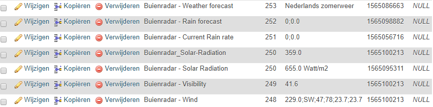

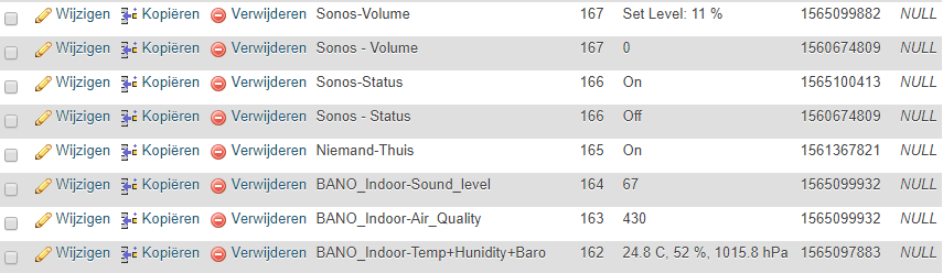

I saw that more values within the database are not broken down in separate values.
2019-08-06 16_08_07-192.168.1.200 _ localhost _ domotica _ devices _ phpMyAdmin 4.6.6deb4.png
2019-08-06 16_08_07-192.168.1.200 _ localhost _ domotica _ devices _ phpMyAdmin 4.6.6deb4.png (30.96 KiB) Viewed 2029 times
2019-08-06 16_08_53-192.168.1.200 _ localhost _ domotica _ devices _ phpMyAdmin 4.6.6deb4.png
2019-08-06 16_08_53-192.168.1.200 _ localhost _ domotica _ devices _ phpMyAdmin 4.6.6deb4.png (34.74 KiB) Viewed 2029 times

Either you update to the latest pass2php version where devicetypes are stored in the dt column of the database or you fill the array with your own devices:
$device, array(
            'PIR-Bijkeuken',
            'zithoek',
            'kamer',
            'tobi',
            'alex',
            'terras',
            'lichtbadkamer',
            'Xvol',
            'Rliving',
            'Rbureel',
            'RkeukenL',
            'RkeukenR',
            'RkamerL',
            'RkamerR',
            'Rtobi',
            'Ralex',
            'luifel'
PIR-Bijkeuken shouldn't be in there. That array holds the devices of wich the data has to be filtered to numbers.
For the other devices you'll have to make something like I did for my badkamer_temp:
elseif (in_array($device, array('badkamer_temp'))) {
    $status=explode(';', $status);
    $status=$status[0];
    store($device, $status);
explode splits a string into a array.
