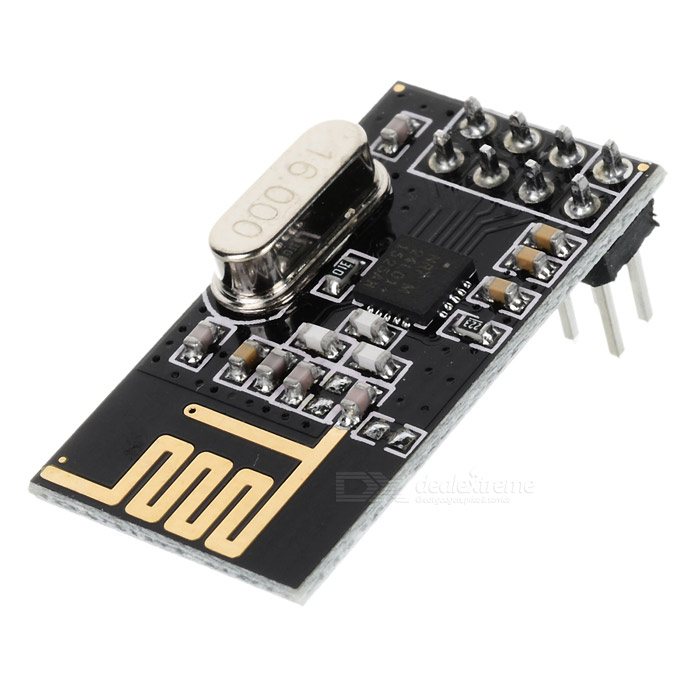

Thanks for this info. I also just now learned there should be a female header on the PCB. And male pins on the NRF? So 8 female-to-male jumper cables should do it? Yaysincze wrote:Last time I ordered solder service rflink 433 mhz
Had a separate nrf in a drawer.![]()
Attached it with jumper wires to the arduino. (see wiring scheme)
Flashed the firmware.
And the whole thing is controlling my milight and 433mhz devices from within domoticz nicely.

I connected my nrf with male to female connectors directly to the arduino mega not to the rflink. Rflink sits directly on arduino (different pins) Because when I bought it rflink was not prepared for additional nrf chip that could be used for milight. That had to be a separate nrf.

Watch the separate antenna for my milight
Sent from my SM-G925F using Tapatalk

Thanks, so not exactly as I imagined it but quite close...
Now I'm again bit slow. Isn't there a built in antenna on the NRF-chip?sincze wrote:Watch the separate antenna for my milight
- sincze
- Posts: 1302
- Domoticz version: 2024.4
Re: RFLink - USB Gateway - Introduction
As you can see the NRF has an on board antenna. Works just fine for me.

Correct, as I understood. Was wondering what you meant with "Watch the separate antenna for my milight"sincze wrote:As you can see the NRF has an on board antenna. Works just fine for me.
- sincze
- Posts: 1302
Re: RE: Re: RFLink - USB Gateway - Introduction
That would be follow the jumper wiresNautilus wrote:Correct, as I understood. Was wondering what you meant with "Watch the separate antenna for my milight"sincze wrote:As you can see the NRF has an on board antenna. Works just fine for me.

Right, got itsincze wrote:That would be follow the jumper wiresNautilus wrote:Correct, as I understood. Was wondering what you meant with "Watch the separate antenna for my milight"sincze wrote:As you can see the NRF has an on board antenna. Works just fine for me.to the separate nrf antenna/nrf pcb hahaha

Well, I received the unit now and understand a little bit better now what we were talking about...
But still not fully clear what is meant by this:
So, as I now have v. 1.1.4 does it then mean I can connect NRF24L01 directly to the socket that is on the Nodo PCB and control MiLights (in my interpretation that is just what it says in above quote)? If for some reason this would not be the case, then I'm a bit lost as it seams the Nodo PCB cover up some of the needed pins mentioned here:http://www.nemcon.nl/blog2/faq wrote:Q: Can I use the NRF24L01 socket on the Nodo PCB for Milight signals?
A: That depends on the Nodo PCB version.
Version 1.1.3 and higher: Yes.
Versions below 1.1.3: No, the NodoNRF socket uses a software SPI solution while the NRF for Milight is using the hardware SPI pins.
Can someone verify I can connect NRF24L01 directly to the socket that is on the Nodo PCB to control Milights?http://www.nemcon.nl/blog2/wiring wrote:Pin 1 = (Ground) = Ground
Pin 2 = (VCC) = VCC (3.3 volt) Warning: Max 3.6 volt, do NOT connect to 5 volt!
Pin 3 = (CE) = MEGA Pin 48
Pin 4 = (CS) = MEGA Pin 49
Pin 5 = (SCK) = MEGA Pin 52
Pin 6 = (MOSI) = MEGA Pin 51
Pin 7 = (MISO) = MEGA Pin 50
Pin 8 = (IRQ) = Not Connected

Could PLEASE tell me the name and/or model specification of the really nice piggy-back-antenna-card?
I have tried to search for it on AliExpress, and none of the names I tries does work?
- sincze
- Posts: 1302
The green one is RFLINK board. http://www.nemcon.nl/blog2/domoticzkar wrote:Hi
The separate antennas are NRF24L01+ tha black one is used for 433 mhz.
