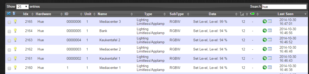

I really hate to bother you guys with this, but I'm still not getting it to work.
The register-proces works now (creates a random user) and then I press "add" and everything seems ok.
However, there are no lights added to the devices tab.
Screenshot added:
Screenshot added:
- Screenshot of added hardware Hue
- PhilipsHue.jpg (176.64 KiB) Viewed 8583 times

Can you post the output ofglobalassist wrote:I really hate to bother you guys with this, but I'm still not getting it to work.
Screenshot added:
http://HUE_IP/api/USERNAME/lights/
(Change the IP and Username to the on in the hardware setup)

I get 6 lights with this, are you sure 'accept new hardware' is enabled in the application settings ?
globalassist
- Posts: 25
- Joined: Monday 09 December 2013 16:51
- Target OS: Windows
Re: [122] Philips Hue support
Damn. I feel dumb. You are right. My apologies!
