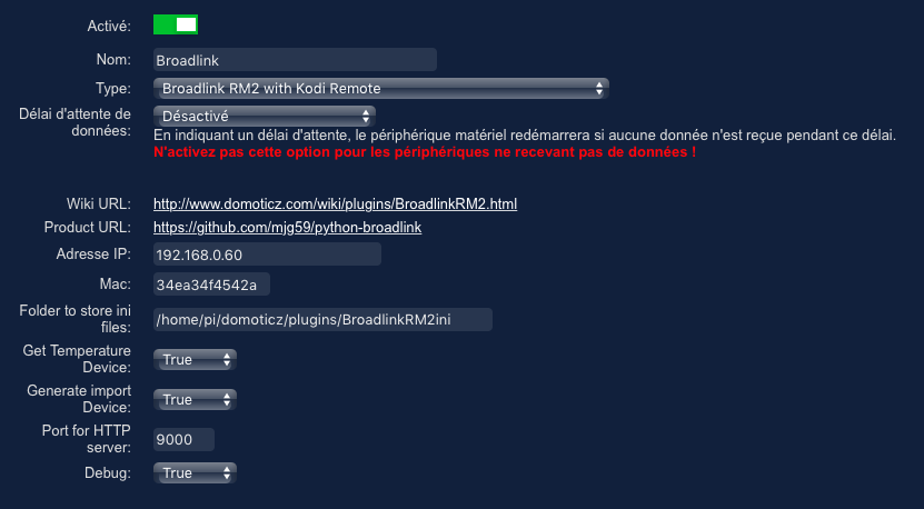

- Posts: 11
- Joined: Wednesday 16 August 2017 10:42
Re: Python Plugin: Broadlink RM2 V3
I don't have the ini file for the remote commande so I can't turn on ..zak45 wrote: ↑Monday 28 August 2017 17:36please provide more information if you want some help.. put also plugin in debug mode and publish log file.sennheiser wrote: ↑Monday 28 August 2017 17:23 Hi,
Someone can help me with the Broadlink Remote ?
Thx
S
The log :
>>ini file not found: /home/pi/domoticz/plugins/TEST/BroadlinkRM2-4-254.ini
S

- Posts: 11
@zak45
2017-08-28 22:30:05.868 User: Admin initiated a switch command (11/Broadlink - Remote/On)
2017-08-28 22:30:05.907 (Broadlink) Calling message handler 'onCommand'.
2017-08-28 22:30:05.907 (Broadlink) onCommand called for Unit 254: Parameter 'On', Level: 0 , Connected : True
2017-08-28 22:30:05.908 (Broadlink) Generate on Command for learned code stored on unit/ini :254
2017-08-28 22:30:05.914 (Broadlink) Code loaded : b20184030a22210b0b210b210b22200c0a0001570a220a220a220a220b210b210b220a220a220a220a220a220a22210b0b21210c0a22200c0a22200c0a220b210b21210c0a0001570a220a220a220a220b210a220b210b220a$
2017-08-28 22:30:06.353 (Broadlink) Connected to Broadlink device.
2017-08-28 22:30:06.353 Error: (Broadlink) 'onCommand' failed 'ValueError':'non-hexadecimal number found in fromhex() arg at position 178'.
2017-08-28 22:30:06.353 Error: (Broadlink) ----> Line 217 in /home/pi/domoticz/plugins/BroadlinkRM2/plugin.py, function onCommand
2017-08-28 22:30:06.353 Error: (Broadlink) ----> Line 319 in /home/pi/domoticz/plugins/BroadlinkRM2/plugin.py, function genCommand
2017-08-28 22:30:06.353 Error: (Broadlink) ----> Line 448 in /home/pi/domoticz/plugins/BroadlinkRM2/plugin.py, function send

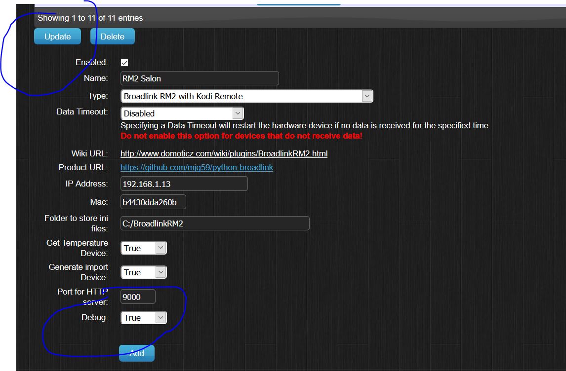

- Posts: 142
- Joined: Tuesday 24 January 2017 23:00
- Domoticz version: 3.8153
- Location: Australia
hey zak
im in a similar boat to other people....
ive loaded the plugin according to the wiki,
when i load it it complains of no place to put ini files...that was my bad....
after i added the path to a location to store ini, the system went under a kinda crash
it shows no hardware, no ability to add hardware, all devices and everything else is gone....
if i remove the ini folder everything returns, but obviously no ability to use it....
V 2020.2 RPI 3

I installed the plugin in my Rpi3 and i want to use it with my Broadlink RM3 mini. On time it works but i had to reinstall the plugin.
Now when i click on learn the LED is On but xxx-command doesn't put On and nothing is learned.
I'm on domoticz Version: 3.8153
Could you help me please?

- Posts: 6
- Joined: Tuesday 29 August 2017 15:16
my problem is only on IR and i haven't got any error in the log.
