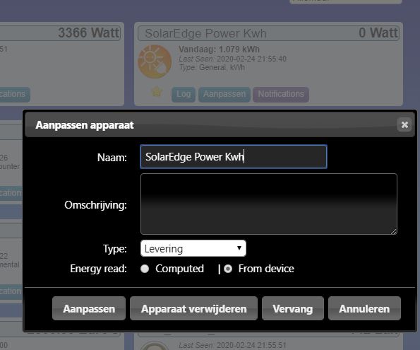

@freijn You did say
I do not have computed but from device
What Sensor Type is your device SolarEdge Power Kwh
I do have Sensor Type Electric (Instant+Counter) and with from device the update command needs to be an other than below?
urlmessage = 'http://'+domoip+':'+domoport+'/json.htm?type=command&param=udevice&idx='+str(domoidx)+'&svalue='+str(domovalue)

Running update every 10 second now and so far there seems to be a difference.
Unlike me you do have SolarEdge_Modbus Hardware i.e. I've missed to add Hardware
Can you share yours including settings?

	Version (Vr)                                        0003.2537
	Serial Number (SN)                                   731E7925
	Device Address (DA)                                         1
Name:  inverter 	Sunspec Id:  101 	Label:  Inverter (Single Phase)
	Amps (A)                                                14.82 A
	Amps PhaseA (AphA)                                      14.82 A
	Phase Voltage AB (PPVphAB)                              243.1 V
	Watts (W)                                                3603 W
	Hz (Hz)                                                50.032 Hz
	VA (VA)                                                  3609 VA
	VAr (VAr)                                              199.48 var
	PF (PF)                                                 99.84 Pct
	WattHours (WH)                                       35072340 Wh
	DC Amps (DCA)                                           9.886 A
	DC Voltage (DCV)                                        370.0 V
	DC Watts (DCW)                                           3658 W
	Heat Sink Temperature (TmpSnk)                          51.15 C
	Operating State (St)                                     MPPT
	Vendor Operating State (StVnd)                              0
	Vendor Event Bitfield 1 (EvtVnd1)                           0
	Vendor Event Bitfield 4 (EvtVnd4)                           0
This request took:  0.60586810112  seconds.
I am running an LUA script that performs the above command and then strips the required data from the result to update a P1 device and text device showing the current Operating state.
Thanks for your help so far. It seems to be two steps forward and one back. I can't seem to be able to install sunspec_ardexa or the SolarEdge_ModbusTCP plugin due to changes in the latest OS (Bookworm Debian). I get the same error on both tries. I did a forum and Google search, but can't really get a good answer. More people seem the have the problem (on the Github discussions also: https://github.com/addiejanssen/domotic ... ussions/70)
