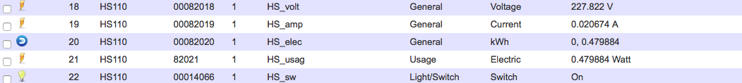

I've installed Domoticz on a raspberry to record the power consumption history with a HS-110.
I've successfully added the device to the dashboard and I'm able to control it
I have 2 questions about the data recovery :
1 - I don't understand how the "Virtual sensors" are linked to the hardware IP adress. I've simply added the idx of the sensors to the editable variables section of the script, but all the sensors are in red. Perhaps that's due to the script error return code?
2 - I get an error when I run the script with the energy option :
The info option works fine :
The generated debug shows that the values are correctly gathered :
Also, here it is the config section of the script :
Does someone have an idea please?
Thanks in advance.

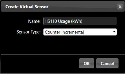

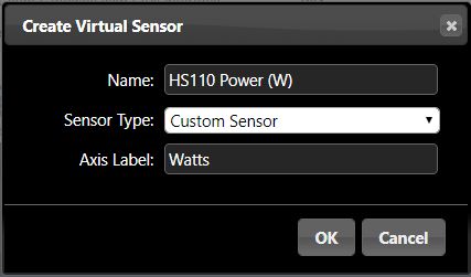

The hardware IP address (hs110_ip variable) is used when reading or 'commanding' the HS110. There is no connection between the hardware IP and the Domoticz device indexes. What you have done in the config section looks fine, assuming your Domoticz URL is on http://rpi3:8080/. You are correct in assuming that the red devices in Domoticz are a result of the error you are seeing when running the script directly.1 - I don't understand how the "Virtual sensors" are linked to the hardware IP adress. I've simply added the idx of the sensors to the editable variables section of the script, but all the sensors are in red. Perhaps that's due to the script error return code?

@ajay100 : I am trying to include my HS110 in my domoticz setup, so once find this thread I immediately tried it
unfortunately I am having similar (not the same) issues experienced by Marc
I created 4 devices (+ the switch, which I don't want to use) as in the attached screenshot, when I run the script I was getting same errors of Marc:
also info option was giving me same results, the difference is in the log file where I cannot see values correctly gathered :
anyhow I tried to remove the division/rounding out and changing the key names as per your post of October the 3rd.
What I get is the following, my terminal is stuck:
No output! And of course only by CTRL+C I can stop the script.
But as you can also see from the screenshot, my domoticz seems to receive the data, but why I don't get an output from the terminal?
How can I have the script running "forever" without issues?
Maybe I misconfigured the devices in Domoticz?
Any help would be appreciated, thanks since now!

ajay100
- Posts: 73
- Joined: Monday 07 August 2017 15:01
- Domoticz version: 4.10717
- Location: Victoria, Australia
Re: TP-Link smart plug HS100/HS110
Hi cerocca,
Well done, you've got it working! Running in the looping mode, you will not see anything in the console and it will look like it's frozen. But you are getting the results in Domoticz, so that is good.
Now you can look at this post (if you haven't already done so) viewtopic.php?f=56&t=13290&p=188061&hilit=start#p188061 to see how I set mine up to start the script automatically at RPi startup. Then you don't need to type anything into the console unless you want to send a direct command (like switching the HS110 off and on, etc.)
Cheers - Andrew
Cheers - Andrew

2. From your Domoticz output, it looks like your hs_volt and hs_amp devices are correct, but you may have hs_elec and hs_usag around the wrong way. My kWh device is for usage and I am using a Custom Sensor for power (Watts). Swap 20 and 21 around where you are setting your index values and see if the results logged in Domoticz make sense. i.e.

ajay100
- Posts: 73
Hi @cerocca,
My HS110 hardware type in Domoticz is: Dummy (Does nothing, use for virtual switches only)
For these settings in code:
My Device settings in Domoticz are:
voltage, index 90 is Sensor type: Voltage. This shows as Type General, SubType Voltage
current, index 91 is Sensor type: Ampere (1 phase). This shows as Type General, SubType Current
power, index 108 is Custom Sensor, Sensor Type: Custom Sensor, Axis Label: Watts. This shows as Type General, SubType Custom Sensor
usage, index 93 is Sensor Type: Electric (Instant + Counter). This shows in the devices list as SubType kWh. It shows both power (watts) and usage (kWh).
usage, index 93 could also be Sensor Type: Counter Incremental (see EDIT below), as shown below. I've only just tried that one!
Cheers - Andrew
[EDIT] Counter Incremental doesn't look right for this purpose. I'm trying Counter now.
monitor_list = ["voltage","current","power","usage"]
domoticz_idx = [90,91,108,93]voltage, index 90 is Sensor type: Voltage. This shows as Type General, SubType Voltage
Cheers - Andrew
