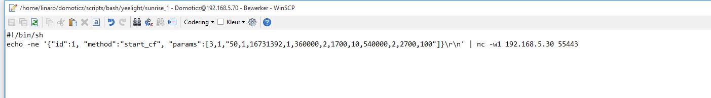

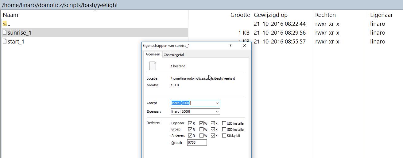

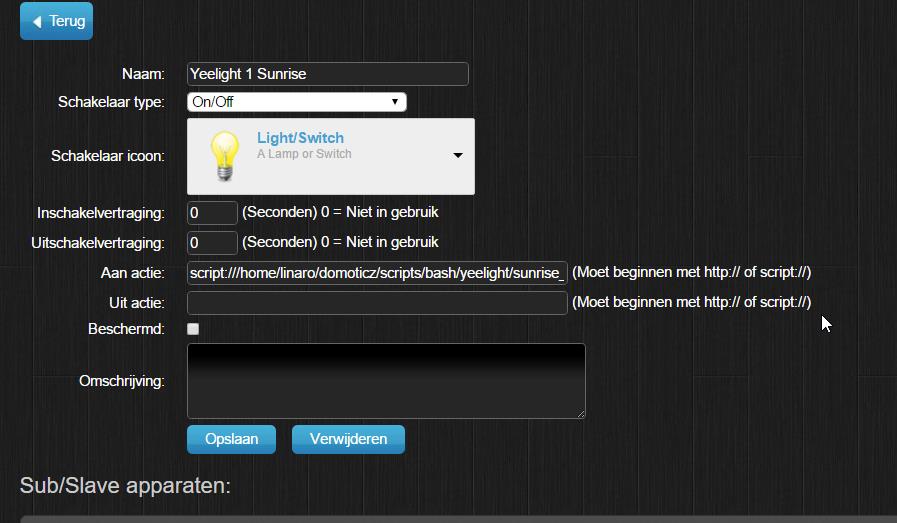

Derik
Posts: 1605
Re: Help with Yeelight Bulb
Post by Derik »
mm
Did make a dummy for the scriptcommand
Changed your ip to my ip [ ido have the 5 range to :-) ]
Did make the file:
Dit put the script:
did make the xxx on the right place:
The light is working with his own switch correct..
Only when i push the dummy switch with the script there is no thing happening...
farhanito
Posts: 34
Joined: Friday 19 August 2016 5:39
Post by farhanito »
Does the script works in terminal? Maybe nc isn't installed
