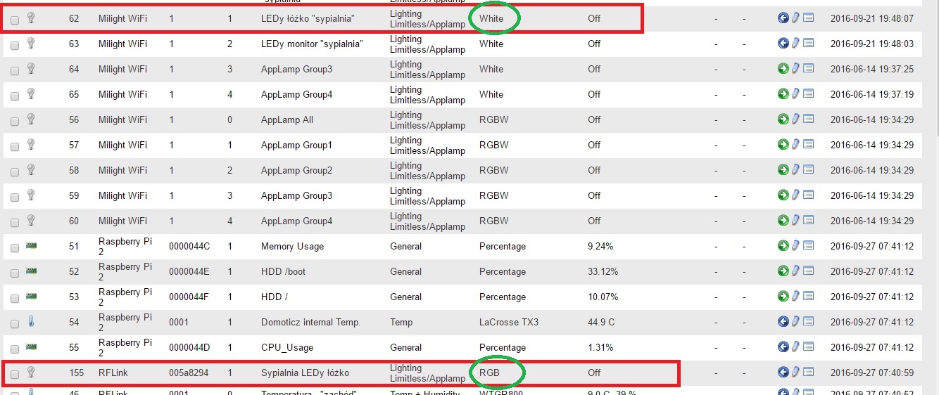

But i have a question. I have Milight led dual white. And when i add controlling to Domoticz as is describe on http://www.nemcon.nl/blog2/faq
Now i have a buuton in Domoticz with setting colors. But how change to only switch on/off with dimmer ? Because for white led i can not set color.

mm how can i learn a milight only on the rflink and not on the milight bridge?farhanito wrote:My Milights work fine with R43, both RGBW and Dual white.

Derik wrote:mm how can i learn a milight only on the rflink and not on the milight bridge?farhanito wrote:My Milights work fine with R43, both RGBW and Dual white.
osmc@osmc:~$ cat < /dev/ttyUSB0 20;8C;PONG; 20;8D;PONG; 20;8E;VER=1.1;REV=43;BUILD=0a; 20;8F;PONG; 20;00;Nodo RadioFrequencyLink - RFLink Gateway V1.1 - R43; 20;01;MiLight=ON; 20;02;PONG;
Q: how to pair Milight bulbs without the original Milight remote control in Domoticz?
A: First check what Milight bulbs you have.
1. Dual white (warm white/cold white) or RGB
2. RGBW
3. RGBWW
Each of the above 3 types has its own protocol.
In case of 1: follow the procedure below at A In case of 2: follow the procedure below at B In case of 3: The RGBWW protocol is not fully implemented yet! We are working on it and hope to have some good news soon.
A) Here is the full procedure to pair a Milight bulb without a remote and use it in Domoticz:
- Go to settings/hardware
- Select "Create RFLink Devices" (if you do not have this option then update to a more recent [beta] version)
- Enter: 10;MiLightv1;5A8294;01;0000;PAIR;
- Power on the Miligh bulb and within 3 seconds press OK to send the entered command
- Bulb will flash 3 times to indicate it is paired
- Again select "Create RFLink Devices"
- Enter: 20;17;MiLightv1;ID=5A8294;SWITCH=01;RGB=8690;CMD=ON;
- Press OK
- Go to settings/devices and press the green arrow to get the bulb under the switches tab
- Go to the switches tab, select the new device and choose "modify"
- Modify the switch type to "Dimmer"
Now you have full control over the bulb.
In the above explanation you can change the ID from 5A8294 to any value you like as long as it starts with 5A!!
B) Here is the full procedure to pair a Milight bulb without a remote and use it in Domoticz:
- Enter: 10;MiLightv1;F746;01;34BC;PAIR;
- Enter: 20;17;MiLightv1;ID=F746;SWITCH=01;RGBW=8690;CMD=ON;
- Press OK
In the above explanation you can change the ID from F746 to any value you like.
You can also change the zone number from 01 to 01/02/03/04 to have the device matching one of the 4 buttons on a remote control.
You can also change the zone from 01 to 00 to only have the bulb active under the zone address.
When you make changes, you need to change them on both commands.
For example:
10;MiLightv1;F746;01;34BC;PAIR; => 10;MiLightv1;0634;03;34BC;PAIR;
20;17;MiLightv1;ID=F746;SWITCH=01;RGBW=8690;CMD=ON; => 20;17;MiLightv1;ID=0634;SWITCH=03;RGBW=8690;CMD=ON;
You can also use RFLink Loader or any terminal program to issue manual commands.I found bug that MiLight White is use in Domoticz from RFLink as subtype: RGB. Should be use as WHITE. This subtype is use for Milight WIFI controller. Becuase now for button from leds white user can setup colors. It is wrong. Look on my screen:

But is any chance to change in Domiticz for MiLight to only can on/off and dimmer without window tonsetup color ? Because for white led Milight setup color is no need.

Can answer about milight : there is 2 way.
1st use group/scene and put your milight on this with your value (mark white & 90%).
2nd just change your device type to classic on/off switch

piokuc
Re: RFlink firmware R43 is available now!
Classic switch ok but i need dimmer function...

- Posts: 784
- Location: Bordeaux France
Scene with various value.
Got a milight group with 4 scene for 4 dimme value (15% -> movie scene, 25% 50% 90%) and to switch off just a scene with off value)
90% scene is pairing to a chacon switch
Other one are activated by a IR remote + irexec script on a kodi rpi.

But i want add original Remote to set as sub device to example fo my led strip.
I learn remote by button LEARN on tab switches but it is problem. Because after learn in devices remote still have status OFF. Never change to ON if i turn ON led strip by remote.
Add remote as sub device will be good becuase i still see status led in Domoticz. If i turn on LED by remote i see it in Domoticz. Wjen off also see in Domoticz.
