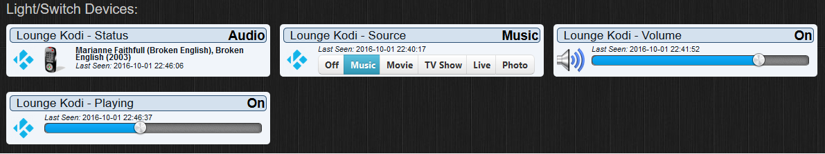

I'm most of the way through adding a Python plugin capability to Domoticz to save everyone from writing C++ and I'm uplifting Kodi support as the 1st test case. The new plugin will map a single Kodi to multiple Domoticz devices (currently 4) and that should allow for a lot more flexibility: New devices can be added with minimal code if required.
What you are after should be possible. I can distinguish Music, Photos and Live TV pretty easily, TV shows encoded with Episode details should work as well but the Kodi only knows about tags that the media contains. I use MythTV as my PVR and I don't think it tags recorded TV the correct details.
Either way this should be more useable because you will be able to Mute/Set Volume/Unmute, Pause/Resume/Jump right off the main Domoticz page. It will also allow configuration of shutdown and WOL which has been a gap previously.
