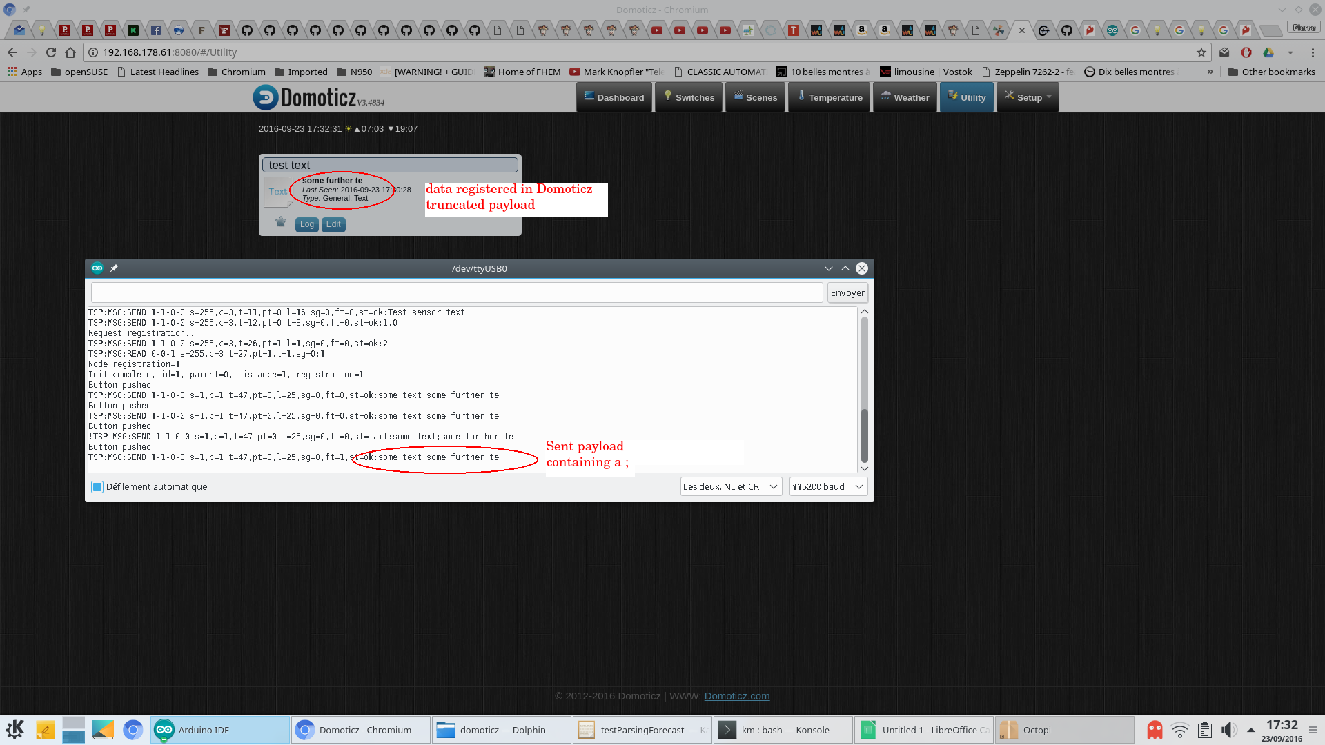

It seems that indeed, the payload gets truncated. I have made a test with a S_INFO sensor sending a V_TEXT. Below the result of the serial monitor and domoticz results:

Post by PierreSt »
Indeed, hence my initial question about the code. Why go through a loop to iterate over all values. If the purpose was to take only the last one a "payload = results[size-1]" would have been enough.
Having said that, looking at MySensors sensors/variables types, it seems that only the V_POSITION is meant to have a ; delimited list of values as payload. And that sensor is not implemented in Domoticz.
The thing with the V_TEXT is IMHO just a corner case by-product.
