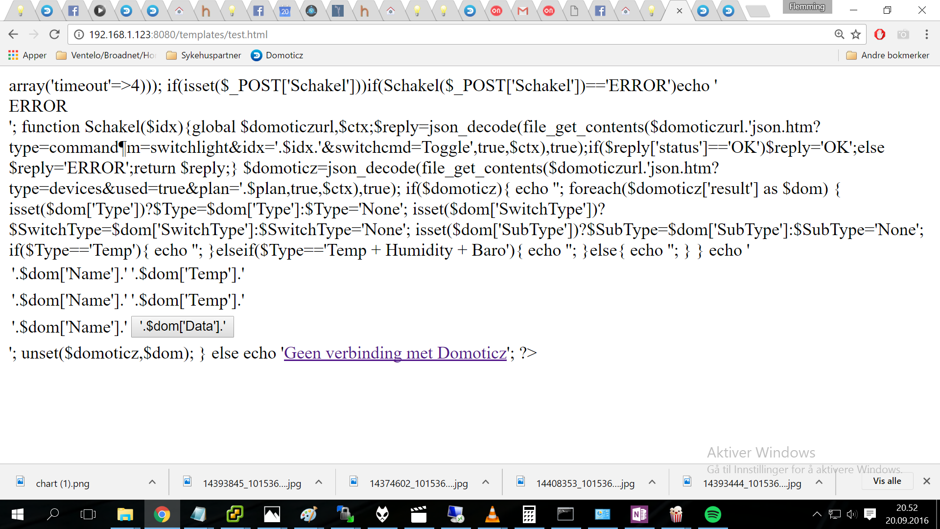

Start with something like this:
<!DOCTYPE html PUBLIC "-//W3C//DTD XHTML 1.0 Transitional//EN" "http://www.w3.org/TR/xhtml1/DTD/xhtml1-transitional.dtd">
<html xmlns="http://www.w3.org/1999/xhtml"><head><title>Domoticz switches</title></head><body>
<?php error_reporting(E_ALL);ini_set("display_errors","on");
$domoticzurl="http://192.168.0.10:8084/";
$plan=3;
$ctx=stream_context_create(array('http'=>array('timeout'=>4)));
if(isset($_POST['Schakel']))if(Schakel($_POST['Schakel'])=='ERROR')echo '<div>ERROR</div>';
function Schakel($idx){global $domoticzurl,$ctx;$reply=json_decode(file_get_contents($domoticzurl.'json.htm?type=command&param=switchlight&idx='.$idx.'&switchcmd=Toggle',true,$ctx),true);if($reply['status']=='OK')$reply='OK';else $reply='ERROR';return $reply;}
$domoticz=json_decode(file_get_contents($domoticzurl.'json.htm?type=devices&used=true&plan='.$plan,true,$ctx),true);
if($domoticz){
    echo '<table>';
    foreach($domoticz['result'] as $dom) {
        isset($dom['Type'])?$Type=$dom['Type']:$Type='None';
        isset($dom['SwitchType'])?$SwitchType=$dom['SwitchType']:$SwitchType='None';
        isset($dom['SubType'])?$SubType=$dom['SubType']:$SubType='None';
        if($Type=='Temp'){
            echo '<tr><td>'.$dom['Name'].'</td><td>'.$dom['Temp'].'</td><tr>';
        }elseif($Type=='Temp + Humidity + Baro'){
        }else{
            echo '<tr>
            <td>
                <form method="POST">
                    <input type="hidden" name="Schakel" value="'.$dom['idx'].'"/>
                    <input type="submit" value="'.$dom['Data'].'"/></td><tr>
                </form>
            </td>';
    echo '</table>';
    unset($domoticz,$dom);
} else echo '<a href="">Geen verbinding met Domoticz</a>';
<script type="text/javascript">
function toggle_visibility(id){var e=document.getElementById(id);if(e.style.display=='inherit') e.style.display='none';else e.style.display='inherit';}
setTimeout('window.location.href=window.location.href;',4950);
function navigator_Go(url) {window.location.assign(url);}
</script>
</body></html>
Add the desired devices to a roomplan and adjust $domoticzurl and $plan as needed.
This is a simple page like this, order of devices is the order in the roomplan. Switch command is 'toggle'.

hmmm. can't get this to work, also, where should i put IDX numbers?
Egregius
Posts: 2592
Domoticz version: v2024.7
Location: Beitem, BE
Re: Frontpage & api
Post by Egregius »
Extension must be php and hosted on a php enabled webserver.

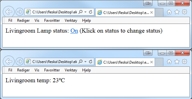

now, I can see this is a script that automatic include all devices in a roomplan (og all in domoticz if "0")
Is it in any way posible to build this so I (preferably without floorplans) can values and buttons/links in my own layout?
Like:
The temperature of the bath is now <IDX/type for device> degrees, and in the kitchen <IDX/type for device> degrees.
Light Status (click to change): Bathrooms: <IDX/type for device> Kitchen: <IDX/type for device>
Also If i could name the status-names myself (not just "on" and "off") that will be good (If i want it in my language eks. "På" / "Av"
i can HTML in a basic level, but not php

I assumed you wanted the simpliest way..
Then I suggest you look at my Floorplan code at http://www.domoticz.com/forum/viewtopic.php?f=8&t=7551
With that code all statusses are stored in PHP variables like $Sdevicename ($S for switches, $D for dimmers, $T for thermometers,...)
Then you can freely use them where and how you want.
About the roomplan: if you call the status of all devices and you have lot's of them it takes way more time to retrieve them.
If you only retrieve the 10 switches you need it'll take like 15msec, if you retrieve 100 devices it'll take more than 100msec.
