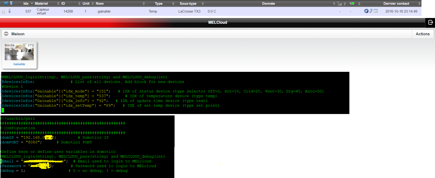

Do you have some floor or area ?
Can you delete them ?
bran2000
Posts: 60
Joined: Saturday 20 June 2015 10:16
Re: [Perl] Control Mitsubishi MAC-557IF-E airconditioning
Post by bran2000 »
My area is composed like this :
Home ==> Kitchen (the unit is here)
gysmo38
Posts: 50
Joined: Saturday 01 February 2014 13:42
Post by gysmo38 »
First thank bagnico for the good work.
I understand the problem is because bran2000 use Areas.
There is different way to add device.
Building -> devices
Building -> areas -> devices
Building -> floors -> devices
I send PM to bran2000 with a version for Building -> areas -> devices.
I will update code to work with three ways.
bran2000
Posts: 60
Post by bran2000 »
just one quick question, in the script v0.4, the switch seems display the status device, is there a way to have a switch which will turn on/off the airconditionning ? or a another switch will set the temperature ?
thanks
gysmo38
Posts: 50
Post by gysmo38 »
I made a news version 0.5.
It should work in all cases now: floors, areas, devices.
It is possible to configure MELCloud login, password directly in domoticz using user variables

artpol5
Joined: Sunday 16 October 2016 10:19
Post by artpol5 »
I create two different files in blocky in LUA.
I changed in the first SCRIPT file from version 0.6:
$domIP = "192.******"; # Domoticz IP
$domPORT = "8080"; # Domoticz PORT
$Email = "email****; # Email used to login to MELcloud
$Password = "motdepasse***"; # Password used lo login to MELcloud
$devicesInfos{"Gainable"}{"idx_mode"} = "151"; # IDX of status device (type selector Off=0, Hot=10, Cold=20, Vent=30, Dry=40, Auto=50)
$devicesInfos{"Gainable"}{"idx_temp"} = "90"; # IDX of temperature device (type temp)
$devicesInfos{"Gainable"}{"idx_info"} = "92"; # IDX of update time device (type text)
$devicesInfos{"Gainable"}{"idx_setTemp"} = "89"; # IDX of set temp device (type set point)
I have changed nothing in the file CONFIGURATION
I have the following errors that appear in the LOG;
2016-10-16 10:30:41.293 Error: EventSystem: in clim: [string "#!/usr/bin/perl ..."]:1: unexpected symbol near '#'
2016-10-16 10:30:41.300 Error: EventSystem: in clim2: [string "#!/usr/bin/perl ..."]:1: unexpected symbol near '#'
an idea of ​​this error?

Merci Gysmo38 !
I created the 2 files but the temperature is not displayed:
Here are the details of my operations
pi@raspberrypi:~$ sudo nano /home/pi/domoticz/scripts/melcloud.pl (SCRIPT)
pi@raspberrypi:~$ sudo nano /home/pi/domoticz/scripts/melcloud1.pl (configuration) don't touch
