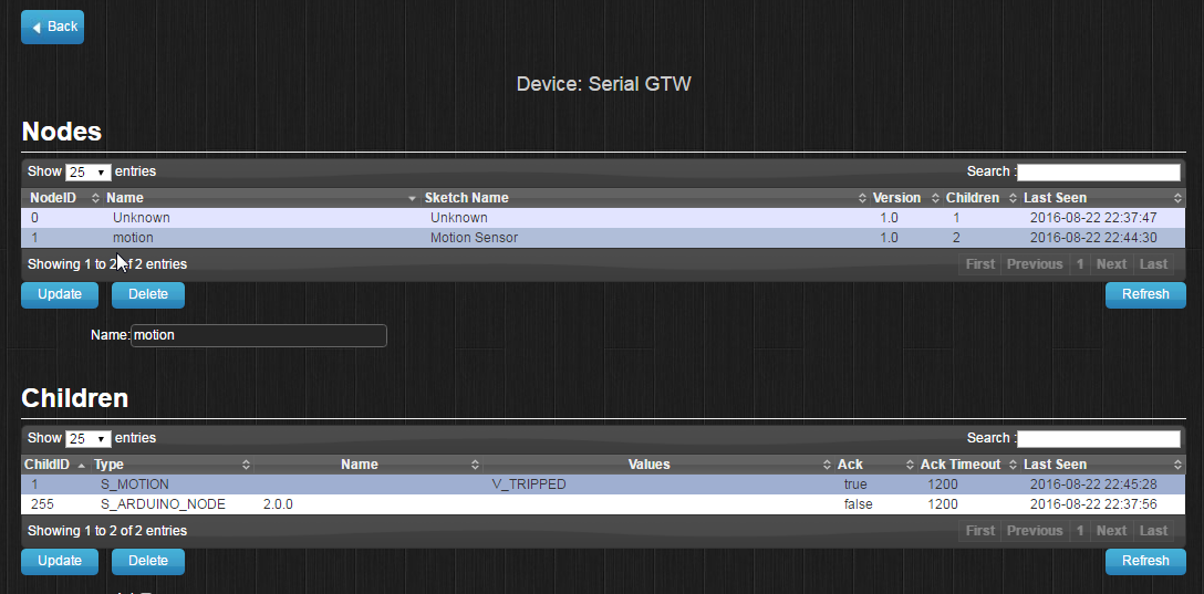

Could somebody can help me? I have made serial Gateway and motion sensor. In domoticz Motion sensor are included as in attachment. Is it correct? Why I could not see this motion sensor on the devices tab? How can I use this motion sensros?
On Arduino serial monitor the motion sensor work properly.
- 2016-08-22 22_59_51-Domoticz.png (94.82 KiB) Viewed 2954 times

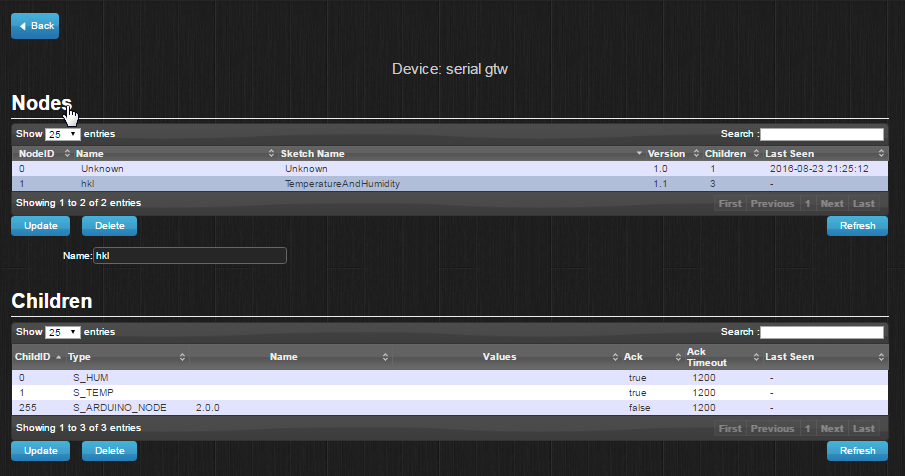

Realy nobody can help me?
Why I dont see any of the device in the device tab? I even made a humidity sensor and install a brand new domoticz with no luck
- 5.png (37.24 KiB) Viewed 2920 times
- 4.png (73.27 KiB) Viewed 2920 times

Logs:
ALL

Have you seen the time between your posts? getting a little bit inpatient there ?
First check if you enabled 'accept new hardware' in the settings
If it is, has this sketch ever send a 'tripped' message to domoticz ?

Between first and second is one daygizmocuz wrote:Have you seen the time between your posts? getting a little bit inpatient there ?
Maybe Im little inpatient because if you do something whole day and it's not working with no clue why you also be little frustrated like me.
The accept new hardware is by default enabled.
How can I see if the sketch send this message 'tripped' to domoticz? If it's not what to check more?

You can debug your sketch in the arduino IDE, and adding debug messages... Serial.println stuff.... you should take more time to familiar yourself with mysensors/arduino first.

I have dig a little bit more and I found that when i change the :
#define CHILD_ID 1
in the motion sensor sketch the sensor show up in device . Maybe my sensor was wrong before and domoticz remember this and not allow add device on this id ? Strange behavior. I will look at the next sensor.

From the log I could say its working. Its not coming to devices?
Node sends first 0 and then 1:
TSP:MSG:SEND 1-1-0-0 s=1,c=1,t=16,pt=0,l=1,sg=0,ft=0,st=ok:0
TSP:MSG:SEND 1-1-0-0 s=1,c=1,t=16,pt=0,l=1,sg=0,ft=0,st=ok:1
Gateway gets the message:
0;255;3;0;9;TSP:MSG:READ 1-1-0 s=1,c=1,t=16,pt=0,l=1,sg=0:0
0;255;3;0;9;TSP:MSG:READ 1-1-0 s=1,c=1,t=16,pt=0,l=1,sg=0:1
Your gateway has include time:
// Set inclusion mode duration (in seconds)
#define MY_INCLUSION_MODE_DURATION 60
When the "accept new hardware" is enabled and node is sending message within the first minute the device should show up in devices tab. From there you should be able to add it as "used device" and give a name for it. After its added from devices tab you should see every update in log.fr3sh wrote:The accept new hardware is by default enabled.
