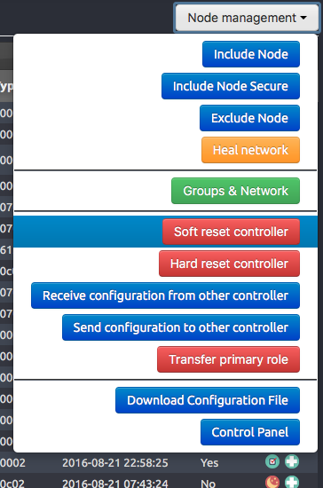

Did you try resetting the controller (soft reset, or hard reset)?
Screen Shot 2016-08-21 at 22.58.36.png (82.55 KiB) Viewed 2445 times
And check the control panel...
