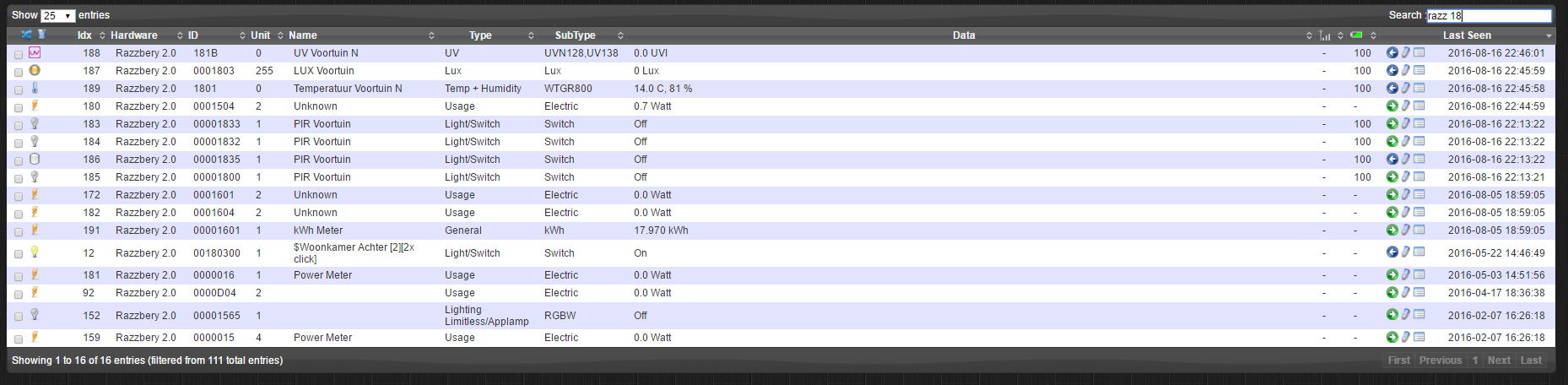

Egregius wrote:Write down the hex value of the node before excluding it so you can filter the table on that to remove the devices.
So example;
I filter 18 from my hex address in the devices table gives me the following result;
This returns 16 devices. as you can see the are not only the devices from my Aeotec sensor, but also from other sensors.
Sometimes it filters more than 25 devices. So this is certainly not full proof workaround for the missing FOREIGN KEY in the DeviceStatus database table.
Or did I misunderstood the way you explained the filter process ?
