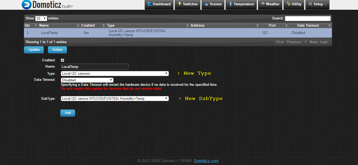

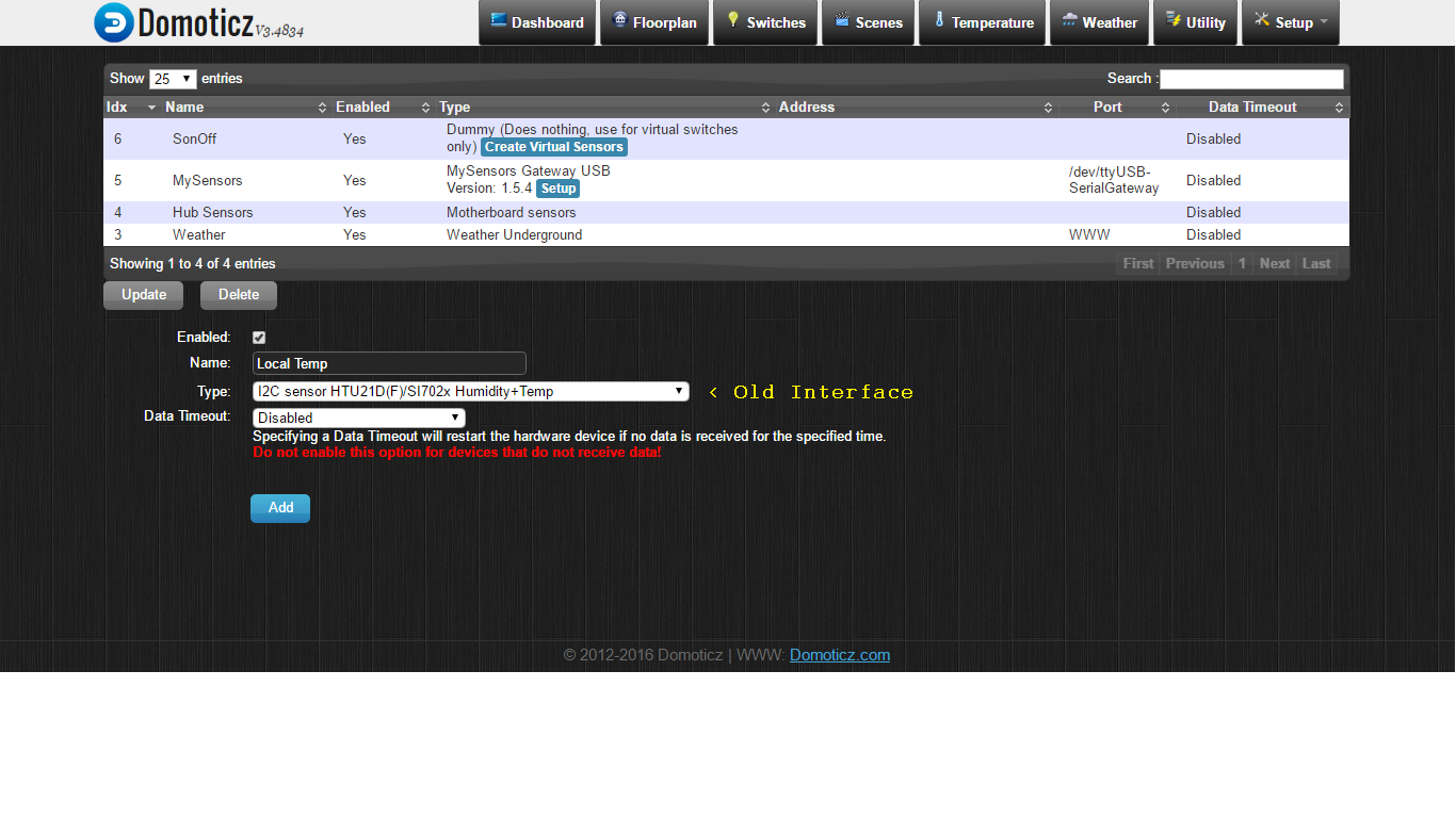

Nevermind. The update didn't help so clean installed it. Now it's working.
- New Interface & Subtype
- nnew.png (159.18 KiB) Viewed 3581 times
- Old Interface
- old.png (205.91 KiB) Viewed 3581 times
