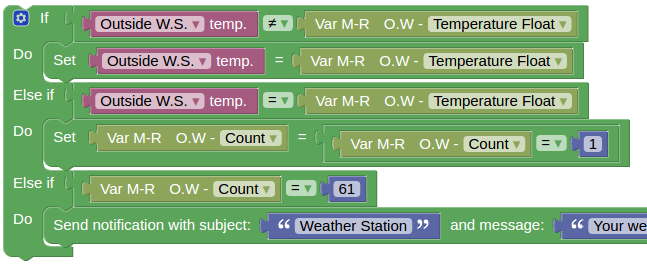

As $user I want to know when my weather station has stopped and are not updating the weather station values anymore.
To solve this I planned to count the times the weather station is sending the same value and if it is still sending the n time I'll notify.
If it's updated I'll reset the counter value to n=1
Here's my built out Blockly in Events:
Screenshot from 2016-08-08 20-12-52.png (50.2 KiB) Viewed 3304 times
(truncated the notification line...)

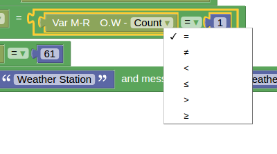

Unfortunately, as you can see, I'm missing the option to update the value of +1
Screenshot from 2016-08-08 20-15-43.png (12.25 KiB) Viewed 3304 times
but it is possible here:
https://developers.google.com/blockly/g ... eb/toolbox
Now, I'm sure there are other ways and probably smarter ways but as I'm not too good at writing my own scripts this is the solution I went for.
Are there any chance I can update the value as I wish with Blocky and Events in Domoticz or do I need to work with LUA or even turn to node-red?
Do I just not find the blocks or is it possible to add these functions into Events for Domoticz?

for some testing purposes I created a virtual text sensor called Counter, I gave it value "0". The following LUA script reads the value, turns it into a number and when my PushOnButton is pressed, it adds 1 to the number and writes the value as a string into the text sensor (the idx of the sensor = 2). This way I can tell how often the button is pressed and it is shown on the Utility tab. Maybe you can use this as an example and create your own solution.
counter = otherdevices_svalues['Counter']
counter = tonumber(counter)
if
	devicechanged['PushOnButton'] == 'On'
then
	counter = counter + 1
	commandArray['UpdateDevice'] = 2 .. '|0|' .. tostring(counter)
return commandArray
