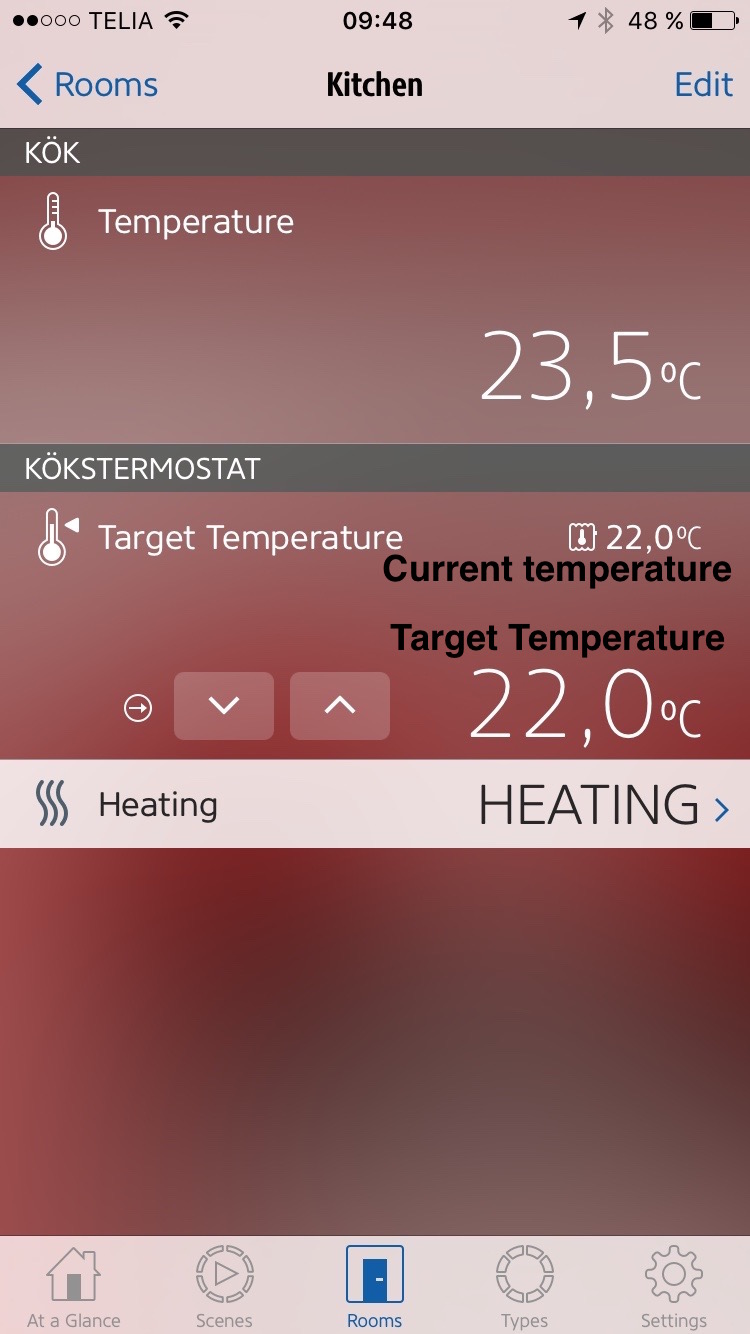

I have som problem with my thermostat when using it in eDomiticz.
I have a Popp Radiator Thermostat (the same as Danfoss LC-13 but this can report the temp) which I can control from Domoticz without any problem.
In Domoticz I can see and set the temperature correctly.
On my iPhone I'm using Elgato Eve to add homekit devices and I can add the Homebridge without problems.
But when I'm viewing the thermostat, both current temp and target temp is the same.
Do you know why and how I can fix this?
As you can see the current temperature shows as a an own accessory also but the value should also be in the thermostat.
Both thees
See the attached image...

See first post, q & a's... need JSON output for the device to be able to investigate.anasazi wrote:Hi,

Sorry about that.Marci wrote:See first post, q & a's... need JSON output for the device to be able to investigate.anasazi wrote:Hi,

When I'm running this "http:/xxx.xxx.xxx.xxx/json.htm?type=devices&rid=ID3, all I get is this:
"ActTime" : 1470476433,
"ServerTime" : "2016-08-06 11:40:33",
"Sunrise" : "05:18",
"Sunset" : "20:58",
"status" : "OK",
"title" : "Devices"
I don't get any result.
Am I doing something wrong?
Tried it with Chrome and JSONView but it's the same...
I'm using an Aeon Labs Z-Stick if it does matter.

S'the ID3 - that's wrong. You want the IDX number for your thermostat from your devices list there... (Settings > Devices in Domoticz)

Got it!Marci wrote:See first post, q & a's... need JSON output for the device to be able to investigate.anasazi wrote:Hi,

Here comes the json output:
"ActTime" : 1470479795,
"ServerTime" : "2016-08-06 12:36:35",
"Sunset" : "20:58",
"result" : [
"AddjMulti" : 1.0,
"AddjMulti2" : 1.0,
"AddjValue" : 0.0,
"AddjValue2" : 0.0,
"BatteryLevel" : 100,
"CustomImage" : 0,
"Data" : "22.0",
"Description" : "",
"Favorite" : 0,
"HardwareID" : 2,
"HardwareName" : "Aeon Labs Z-Stick",
"HardwareTypeVal" : 21,
"HaveTimeout" : false,
"ID" : "0000501",
"LastUpdate" : "2016-08-06 12:34:52",
"Name" : "Kökstermostat",
"Notifications" : "false",
"PlanID" : "0",
"PlanIDs" : [ 0 ],
"Protected" : false,
"SetPoint" : "22.0",
"ShowNotifications" : true,
"SignalLevel" : "-",
"SubType" : "SetPoint",
"Timers" : "false",
"Type" : "Thermostat",
"TypeImg" : "override_mini",
"Unit" : 1,
"Used" : 1,
"XOffset" : "0",
"YOffset" : "0",
"idx" : "2"
"status" : "OK",
"title" : "Devices"
- Marci
- Posts: 532
- Joined: Friday 22 January 2016 18:00
- Domoticz version: 3.8153
- Location: Wakefield, West Yorkshire UK
Re: eDomoticz Homebridge-Plugin
The data and setpoint fields are the only two we care about - both read 22. Is that the case? (Presume one is current, other is target)

Correct!Marci wrote:The data and setpoint fields are the only two we care about - both read 22. Is that the case? (Presume one is current, other is target)
Here is the output for the temperature device in Domoticz which is from the same physical thermostat device as device 2 (idx):

So the current temperature should be around 23.5 and the target 22.

Right. The two are separate devices within Domoticz. Nothing can be done without some butchery. HomeKit expects a single device to present all the info, not to be split across multiple devices.

It's not something I can fix really... until Domoticz handles the thermostat within a single device, the plugin can't. S'just a general incompatibility between Domoticz' way of handling that particular hardware vs the apple-certified way.

Nb: the thermostat will still work correctly. Changing the setpoint will still work, but any on/off rules based on that setpoint are handled by Domoticz, not HomeKit.
Ie: problem is visual, doesn't affect functionality.

Nautilus
- Posts: 722
- Joined: Friday 02 October 2015 12:12
- Location: Finland
This might be more of a question to Homebridge devs but after updating the plugin yesterday I'm only getting "Sorry, I can't do that." from Siri but e.g. the Eve App is showing devices correctly and also controls them. Any idea what might be causing the issue with Siri? I had not used Siri for a while so I cannot say for sure if the update had anything to do with it
=== EDIT ===
Ok, this was "solved" by resetting the homekit configuration. Do you think there would've been some other way which would not have involved loosing the configuration?
=== EDIT ===

- TheRamon
- Posts: 126
- Joined: Tuesday 12 July 2016 11:32
- Domoticz version: BETA
- Location: NL/DE
This is probably because something got messed up along the way.. I don't think there's any way to debug this. Only thing is to remove the "persist" folder and try again.. A pain, I know.Nautilus wrote:This might be more of a question to Homebridge devs but after updating the plugin yesterday I'm only getting "Sorry, I can't do that." from Siri but e.g. the Eve App is showing devices correctly and also controls them. Any idea what might be causing the issue with Siri? I had not used Siri for a while so I cannot say for sure if the update had anything to do with it
=== EDIT ===
