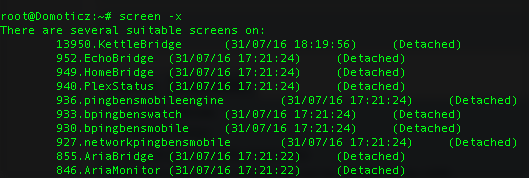

I forgot, to detach from a screen session use cntrl a d (press the 3 buttons on the keyboard).
Think of screen like multiple "windows" for linux terminal, those windows remain running even if you disconnect from the terminal session. It's a good way to run programs in the background and on boot.
I have a lot of screen sessions used in this way.
screen 5.png (29.03 KiB) Viewed 1050 times
If I wanted to connect to the KettleBridge session the command I'd use would be: screen -x 13950.KettleBridge
to disconnect back to the main terminal I'd use cntrl a d
