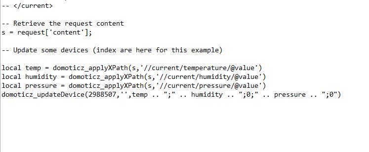

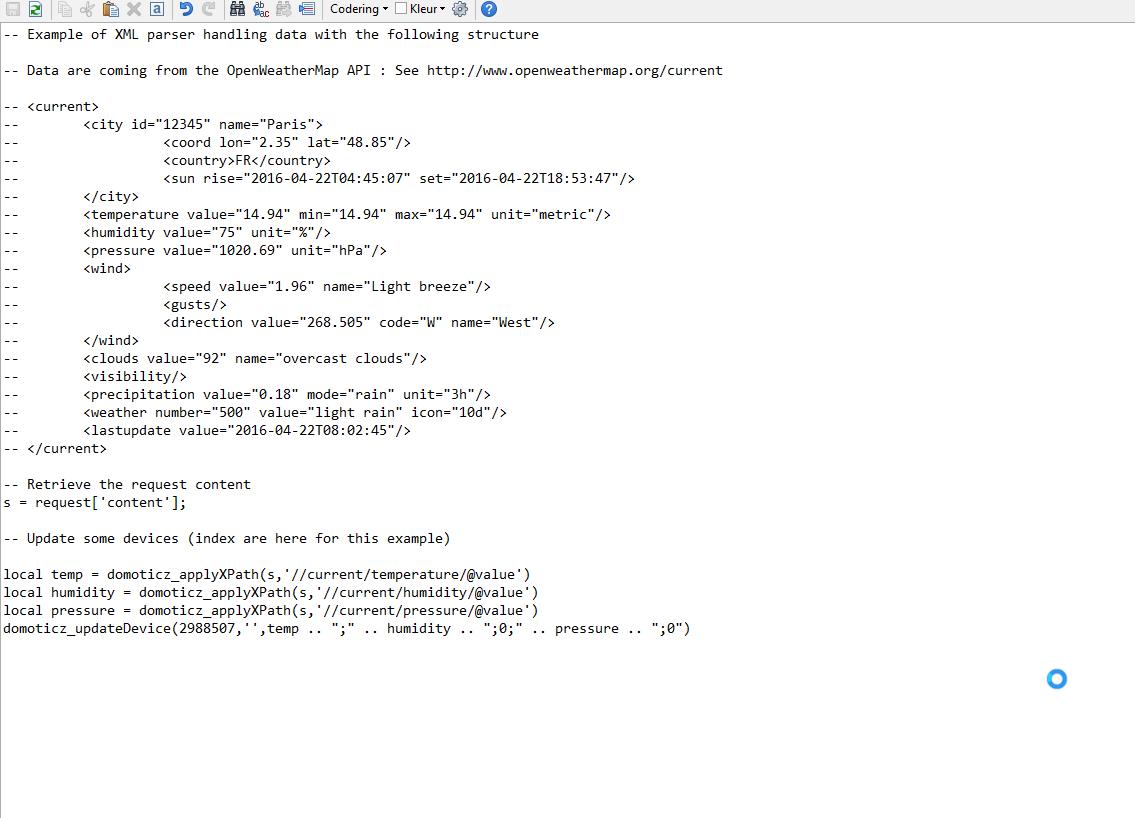

Only is there some one that can explane this thing to me.
I now that i need a account.
Only i do not understand how i get this script to work..
It is not a time or a device .lua.
Do i need a Crontab?
And do i need for all device a new IDX or can i get all the data in 1 sensor? [ what type? ] Or do some one have a example script with all the [ max ] options.

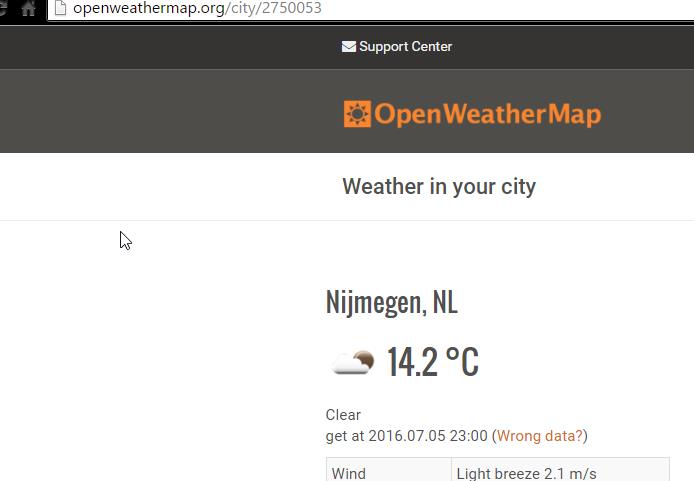

As you can see in your last screenshot, it update a temp+hum+baro device, but not correct, as the forecast is always set to 0
You would like to have the forecast as well
This can be created with the 'weather number' value i see in your first screenshot
