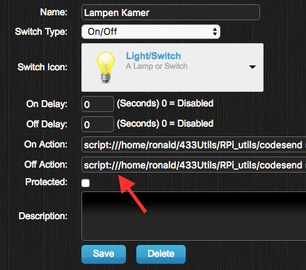

I'm sorry to say that GPIO hardware on this case is not usefull...rfsniffer doesn't use gpio as a "switch".
Juste create a dummy hardware and place codesend typo or on and off that all.
With this "how to" you just open and close GPIO17, who doesn't need to move.

That not what i'm saying...
Just try to explain that you dont have to create a gpio hardware on Domoticz to use "codesend".
Codesend + wiringpi got already all configuration to drive gpio.
The way who is shown, just turn on and off a gpio who is already drive by codesend.
This is the same way since RPI1

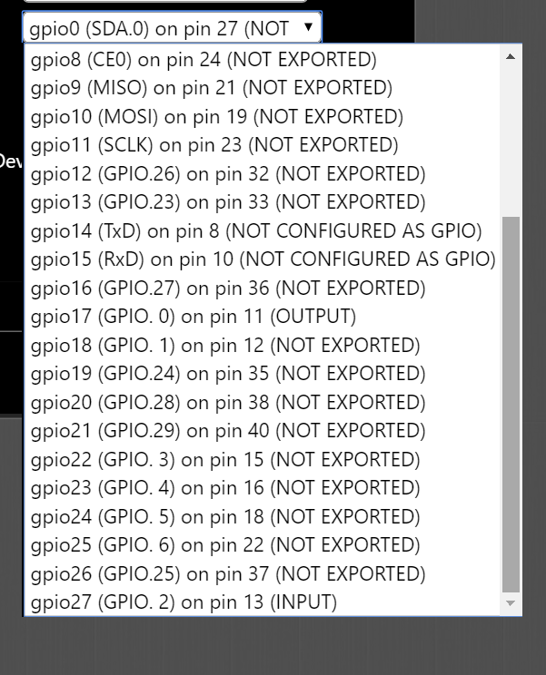

I need some help here. I've connected everything as instructed, installed the bits as descriped, but the RFSniffer gives no numbers when clicking my (KAKU) remote. Any suggestions or ideas?
UPDATE:
When I run RFSniifer the log goes bonkers and makes Domoticz unresponsive.
UPDATE:

I have also got this working.
I did not create a dummy but followed mostly the first posts Wiki.
I first had some trouble installing the ninja stuff. I had to change a line in the Makefile for the compilation to work
(CXXFLAGS=-DRPI change to --> CXXFLAGS=-DRPI -pthread)
After changing one warning remains but al works fine.
After using the RFSniffer I had some trouble with the RX. but that was related to a faulty wire..
Got the codes and could turn on/off the lights from the cli... (yah!)
Then of course in Domoticz tried with script:// but nothing happend..
the 3 slashes tip was also a very needed one!
Many thanks for the first poster!
