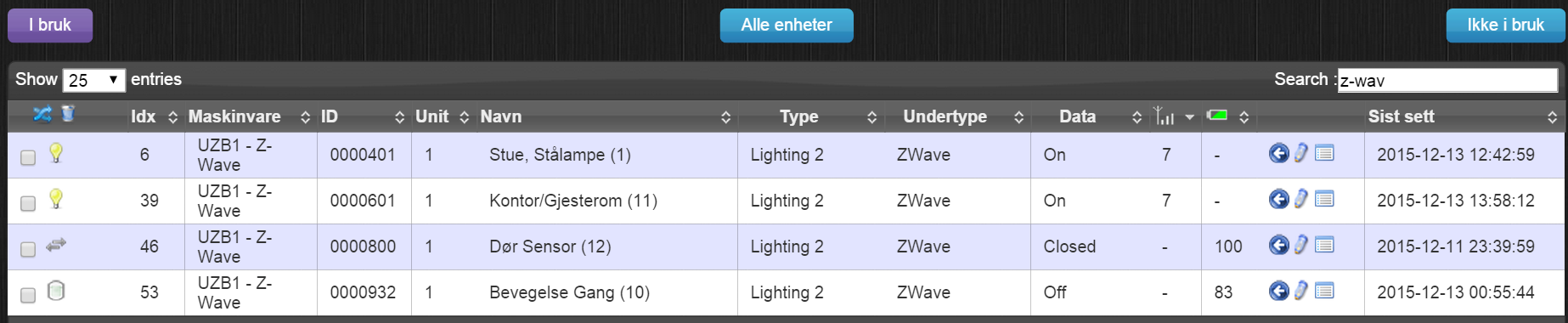

12. Non of my battery-powered devices are reporting signalstrength, is it posible to see this?
Uten navdfdfn.png (151.45 KiB) Viewed 7598 times

12. The signalstrength is only for 433Mhz devices i thought.

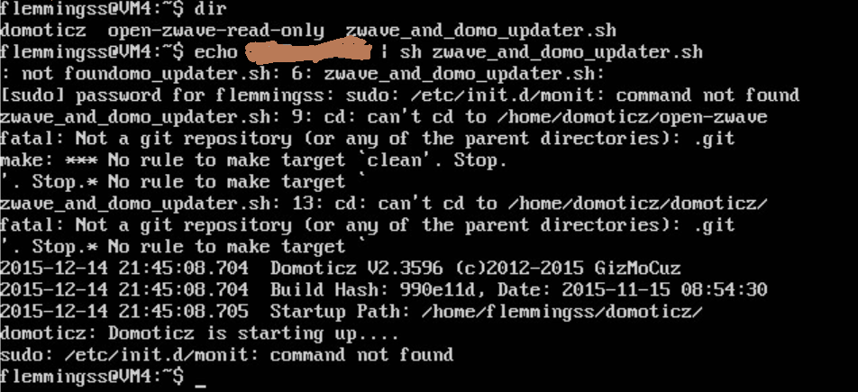

idk if this worked?
Uten navn.png (163.73 KiB) Viewed 7456 times

You have to change the paths in the script, to those of your Zwave and Domoticz location :)
And you can remove the Monit lines because you don't seem to have Monit installed.
