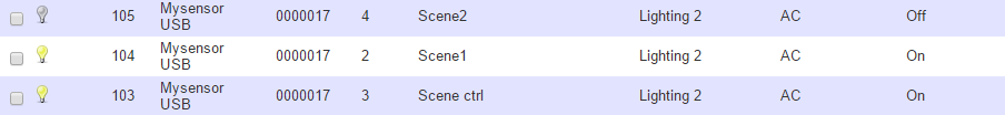

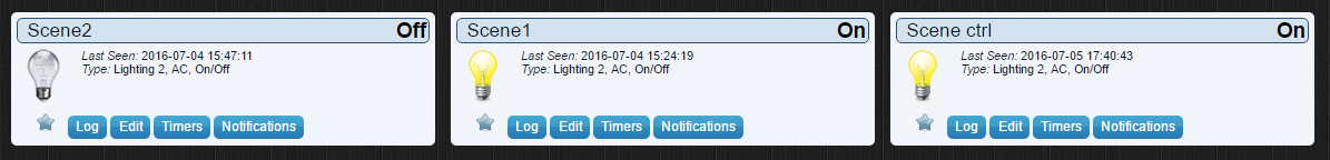

When i connected my node to domoticz i got 3 devices, scene 1 (child 3), scene 2 (child 4) and one device called "Scene ctrl".
It seems to me that the two devices (scene 1 and 2) is controling the "scene ctrl" device on and off, and the "scene ctrl" is the one that controls the actual scene (activation device).

activation device for scene
Mysensor node/child devices
Devicelist
Devicelist

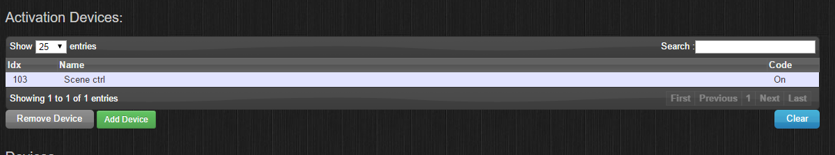

Sorry indeed I meant to say group, I was confusing the scene controller with scene's... :-) I'm using a single scene controller as activation device to toggle the group between on and off state as you can see in the attachment.
