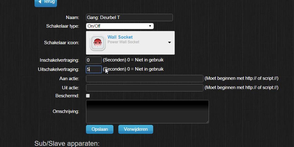

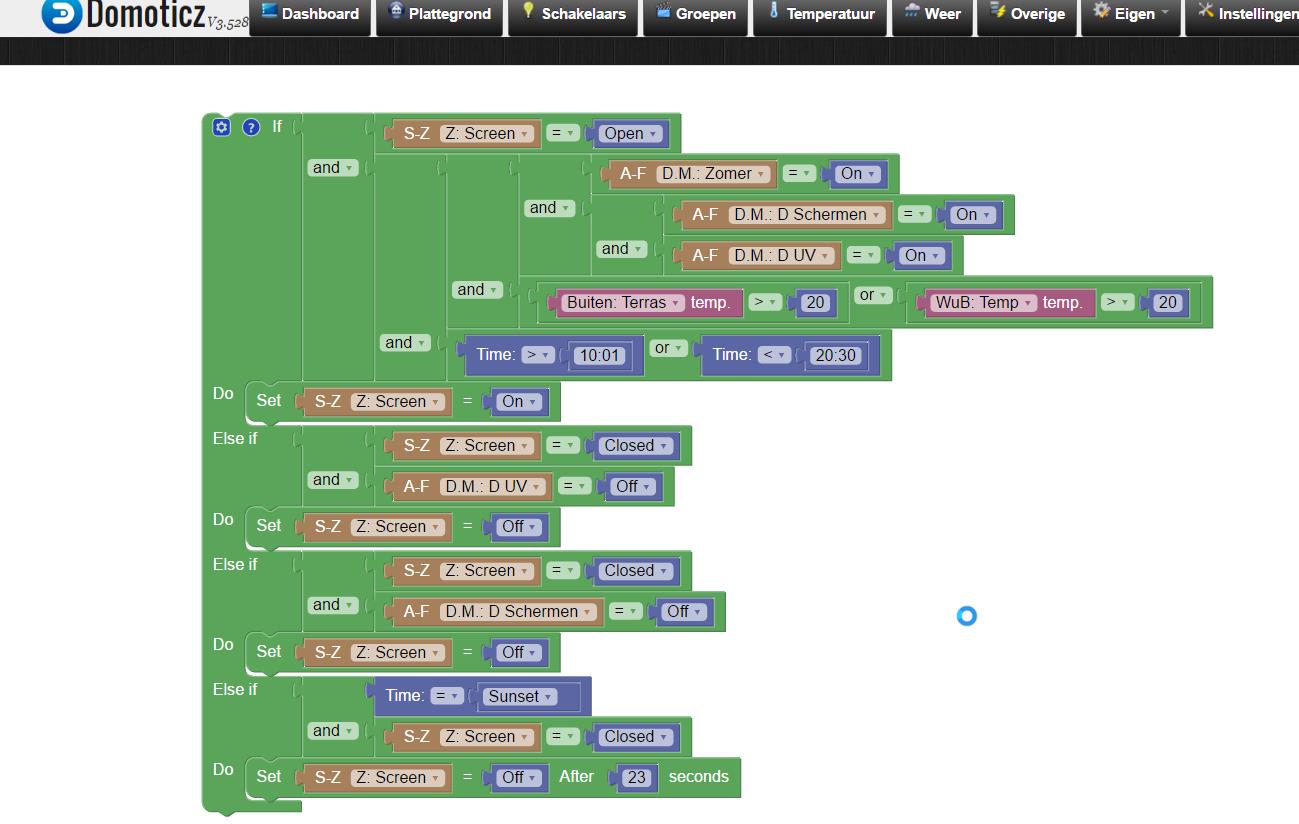

This may be an easy one but I've looked and didn't find anything yet so I'll post this question. I want to set a switch ON duration for a fan. The idea is that when the switch is activated it stays on for a given duration - like 10 minutes - and then turns off. How would one go about this in Domoticz?

Perhaps:
With Blockley..
Plenty options..
Or:
With this great option
atatistcheff
Posts: 17
Joined: Sunday 19 June 2016 18:16
Domoticz version: 3.8153
Re: Set Switch On Duration
Post by atatistcheff »
Awesome thanks!
