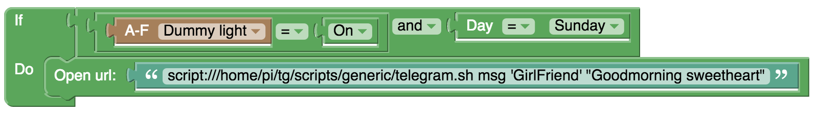

Hello all,
Consider this as a newbie question.
I have blocky events and also scripts that are running fine and I would like to combine them.
For example when I turn a dummy switch on, on a sunday, I want to send my a Telegram message to my girlfriend (see attachment).
Lua Script command:
script:///home/pi/tg/scripts/generic/telegram.sh msg 'GirlFriend' "Goodmorning sweetheart"
Usually I use a workaround by creating an scene that runs a script when turned on.
But in this case the script has in input of a string that is variable, which means I should make a lot of scene's with different text as input.
Hopefully one of you guys has a creative way to solve this!
Kind regards,
Duan

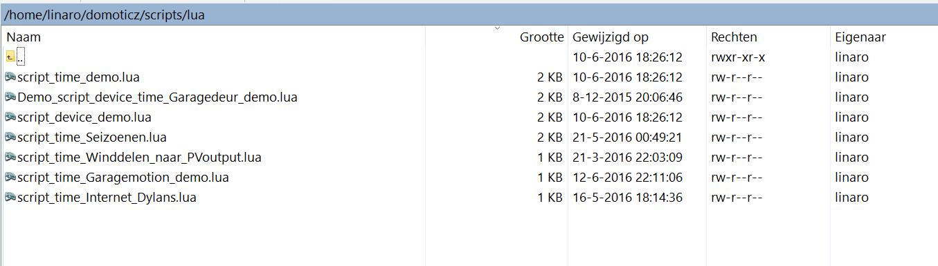

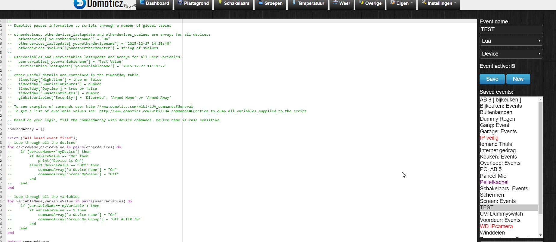

When i make a LUA here:
Where can i find it here:
Because i make a backup weekly of all my scripts...[ save a lot of time when my Domoticz crashed ]
jvdz
Posts: 2330
Domoticz version: 4.107
Re: Scrips with variable input in blocky events
Post by jvdz »
You won't find any files for the internal script editor scripts, as these scripts are stored in the domoticz.db, where also all other data is stored for domoticz, as far as I know. So you should be good when you have that in your backup process.
