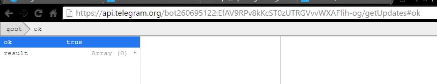

Got a Bot:
Got the update:
Only i cannot find the chatid:
Duan
Posts: 9
Joined: Saturday 20 February 2016 8:41
Re: Telegram does not show devices
Post by Duan »
Try to chat with your bot first and go the the link again. If you don't chat with your bot it can't give you results back which contains the chatId
