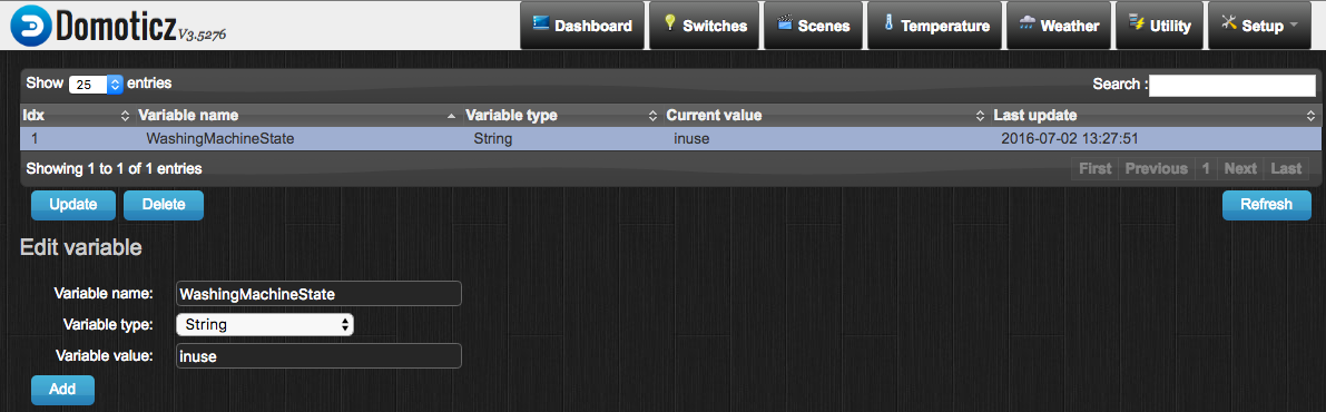

It uses a user variable which you will need to manually create prior to running the script, see below screenshot.

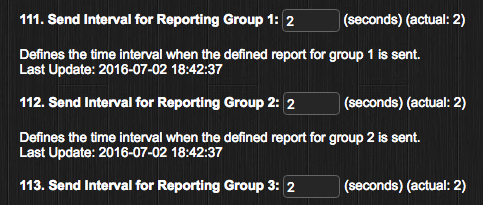

If your using Z-Wave don't forget to increase the rate that the device sends its status to Domoticz
I use 2 seconds for most devices, they send the power in watts to Domoticz every 2 seconds.
Screen Shot 2016-07-02 at 8.02.36 PM.png (87.98 KiB) Viewed 1829 times
This time allows me to do things such as (I recently purchased a document shredder), when I shred a document Z-Wave detects the power increase in watts from the Shredder and I get a verbal announcement "Shredding complete.". :D
If 2 seconds is not quick enough you may use 1 second in some cases although you want to keep this to a minimum due to the increase in traffic over the Z-Wave network.
I've found it's possible to turn a lot of "dumb" devices into smart devices simply by looking at their power consumption in near realtime.
