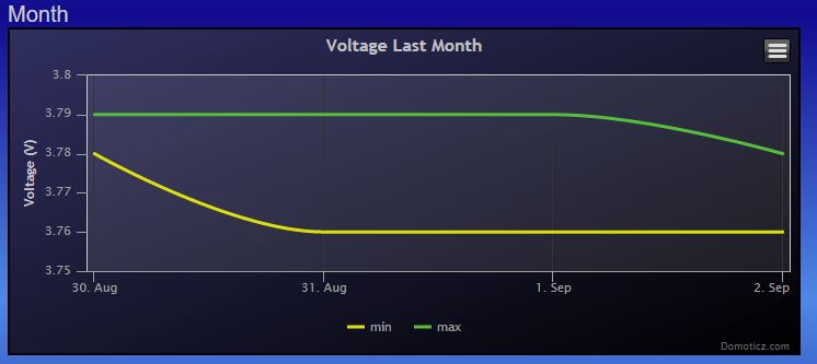

Even better (in MySensors) is to report the battery level through a S_MULTIMETER type with V_VOLTAGE. This way it will show up like
