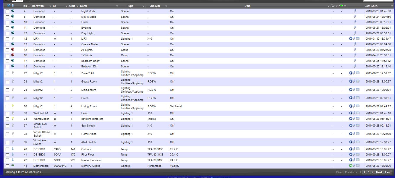

Here are the execution and console logs for a switch and a sceneMadgeni wrote:can you just put a console.log in both cases of the switch statement ("i'm in Switch") or ("i'm in Scene"), just to make sure it's calling the scene case? Also, silly Q, but you the scene you're controlling definitely has an IDX of 4?
Have also attached a screenshot of the devices - Both the switch and scene are captured there justt in case it helps with the debugging

- Domoticz Devices list
- Capture.JPG (140.35 KiB) Viewed 3766 times

I think i've got it -
It's my fault for not explaining this - so Domoticz manages Scenes differently to switches etc, and stores them in a different table, allowing them to have the same IDX.
Alexa can't (rather understandably) handle this, so i cheat - essentially converting the IDX into a number, add another number to it to provide a unique IDX.
When testing it, can you try 204 for the IDX, rather than 4?
Still not sure why you're not getting good feedback though, but this should fix the Scenes
