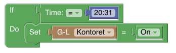

micbou wrote:and its weird because below does work
And if you try this with a fixed time?
So when the "door?" is open on that time?

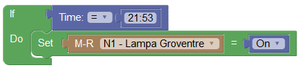

can anyone explain why this doesn't work?
Event not working
Event not working
Skärmavbild 2016-06-09 kl. 20.40.47.png (12.38 KiB) Viewed 5981 times
Simplest event there can be and it's not working.
I'm not able to get any event to work that i have tried.
Timers working fine but not events :cry:
I found a similar post earlier but no solution for the problem.
I'm actually getting this error in the logg
2016-06-09 20:59:00.497 Error: EventSystem: Lua script error (Blockly), Name: test_1 => [string "result = 0; weekday = os.date('*t')['wday']; ..."]:1: 'then' expected near 'NaN'
Best regards
Jonas

BullHead wrote:Hi,
That's strange...
However, seems to me that you are using wrong kind of logic...
And this is from the log:
 2016-06-09 21:55:00.435 EventSystem: Event triggered: 01 - Test_1
2016-06-09 21:55:02.427 (RFXCOM) Lighting 2 (N1 - Lampa Groventre)
Using Domoticz V3.5228

Minglarn wrote:
That's strange...
Build Hash: 76374d0
What kind of logic should I use?
How did you get the bluish "Time field"?
I think i have found whats causing the problem...
I use a Raspberry Pi B+ with no built in WiFi so i have used a USB WiFi.
Tp-Link TL-WN725N V2.... i have to install the drivers manually for that device.
So i tried with a fresh install of Domoticz and skipped the WiFi part and now everything is working again! :P
Best regards
Jonas

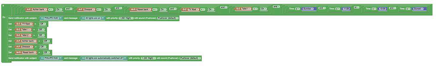

Post by desertdog »
After a power failure all Philips Hue lights are turned on at 100%. So I build this script to notify me if this happens and autmatically turns the lights. The function is based on all lights being on between sunrise and sundown, a situation that would never happen being set manually, no matter how dark and stormy a day is as there are also some colored moodlights which are never turned on during the day
