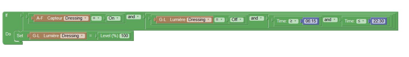

I'm facing an issue here with my fibaro FGMS001 and my fibaro dimmer using blocky script for simple dummy script :
what i want to do is :
but i get this error message that i don't understand :
2016-06-14 22:03:00.253 Error: EventSystem: Lua script error (Blockly), Name: Dressing light day time_1 => [string "result = 0; weekday = os.date('*t')['wday']; ..."]:1: unexpected symbol near ']'

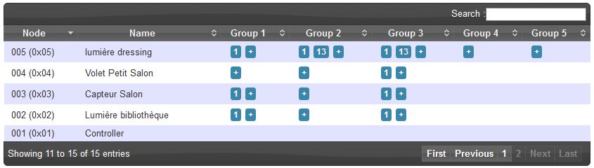

also here is my group and network :
can you polease guys help ... i don't know why it is not working.

i have the exact same config !!! and it doesn't work... even a simple if sensor is ON turn on light doesn't work ...
this is realyl weird.
ps: how do you get the blocky script to show like this .. mine has horizontal layout ...
FLo

Right click the "and" block and set "external inputs". I find the logic much easier to follow like that.
Just a thought, assume as you are using "level%" that your switch is a dimmer type?

StanHD i don't know why but i think the main problem was a cache issue with firefox .... as soon as i started using chrome (clean cache) it worked right away !!! the script colours are now corret caus eif you ceck my first post time switches were not blue but green etc etc ...
well now everything is working like a charm ! and also Thx for the AND "external inputs" way better to work on Blocky scripts
