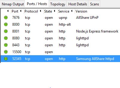

I used the Domoticz build-in "System Alive Checker (Ping)" to determine if my Samsung TV's are on or off. However, last week my EU40H6200 got a firmware update. Since then, it always replies to a ping. Even when the TV is turned off.
I did an nmap to check for ports that might be used to find a new way of getting the power state of this TV. These ports seem to be open:
ports
ports
samsung ports.JPG (29.09 KiB) Viewed 25299 times
So I don't want to control the TV. I just want to be able to determine the power state without having to buy a power plug with energy usage reporting capabilities. Is there a simple way? I am not a programmer but could this node.js express framework (port 8001) be of any use?

It doesn't wor with UE48H6500 (api ver 2.0) model of 2014. :(
Ah! it has not 55000 port open, it has 15500, but it doesn't obey commands...

I use a simpler way to achieve this.
i own a Samsung UE40H6620SV SmartTV and detect by Network if the Samsung is on or of. It also works when Samsung is in standby mode.
I use this to prevent the lights go off when i watch late television, it works perfect.
1 - i installed new hardware type "System Alive Checker" (ping)
2 - I'm attaching the IP Address of the Samsung to "settings"
3 - Result is a virtual switch
When i try to add images as an example, i get the message "Sorry, the board attachment quota has been reached".

Newer Samsung TVs ( >2014) have a different protocol and the 55000 port is not available any more.
