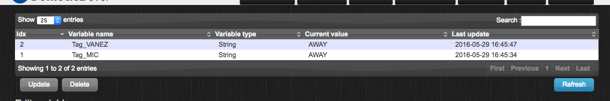

woody4165 wrote:"active (running)" seems to be ok.
When you launched directly check_beacon_presence.py habe you seen if RSSI was changing or if ibeacon were changing status if you move it outside the range?
Both have been in AWAY mode since I set them up

woody4165
Posts: 476
Joined: Monday 14 March 2016 13:55
Location: Rome, Italy
Re: How to check presence of Beacon ?
Post by woody4165 »
Check the log
