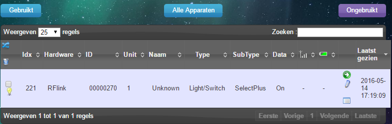

I bought Select Plus at the Action today for €5,95 en it's showing up in hardware after learning
Note: (SelectPlus200689101 supported by RFX)

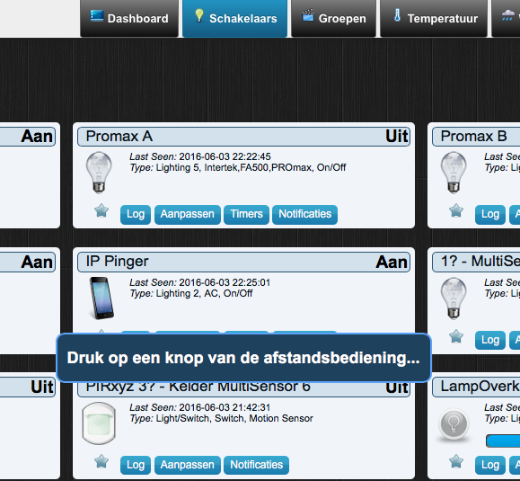

Learning the Domoticz, is very easy:

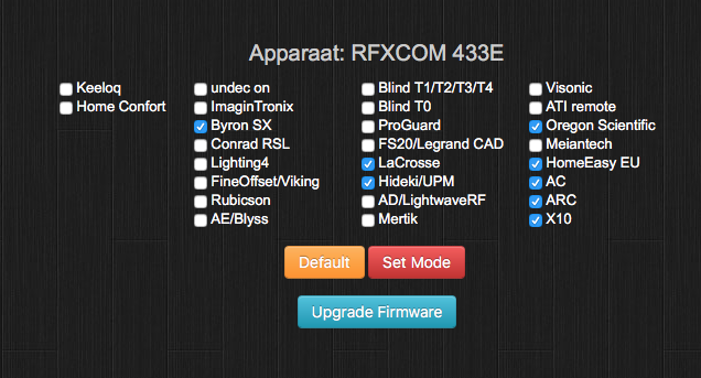

I have the latest firmware on the RFXcom (not sure if that is a must though), under hardware I have following devices selected:

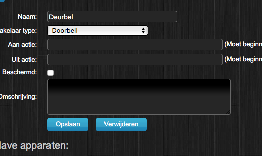

Than go to Switches (schakelaars) en use the left learn (leren) button. Now press a few times on the button of the doorbell switch (first put the battery in it of course
). Than Domoticz will recognize it, now you can add it as a doorbell in Domoticz.
Good luck.

I think the problem is that I need to add the Byron protocol. But I cannot find where to select the protocols: I cannot find the screen that is posted above.
EDIT2: found it: go to Setup, Hardware and click on the button 'Set mode' in the line where your RFX is! It is called 'Modus instellen' in Dutch. Select Byron SX, click 'Set mode'. Domoticz will jump to the first tab. Don't worry that if you open the same screen again, Byron is de-selected. It will still work...
EDIT: I just found viewtopic.php?t=19204. Seems to be a similar question.

I was also struggling with this doorbell. Domoticz wouldn't recognize it. In my case I needed also to enable Lighting4. Just for your information.
