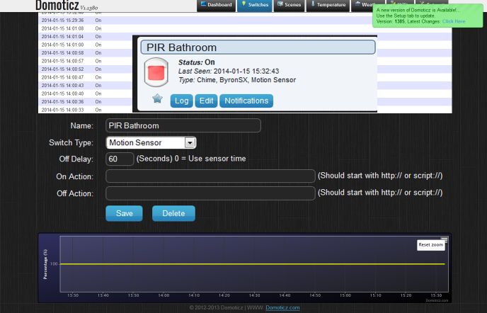

Simon - Are you using the Siemens PIRs? Even if I set them as on/off switches, they do not turn off - Ie you can't even turn them off by clicking the device.
simonrg
Posts: 329
Joined: Tuesday 16 July 2013 22:54
Domoticz version: 3.8807
Location: North East England
Re: ByronSX PIR
Post by simonrg »
Rob - I am using the Siemens PIRs - I can't switch them off either, however what counts is not getting a "detected signal" - I have now left the PIR1 = Off line out of the blocky script and still works. It appears that Domoticz is smart enough to know that this is PIR and can only send a "detected signal", so doesn't respond. However, I can confirm that the blocky script does what it says on the can, i.e. if I either activate the PIR or click on the on/off icon then my study light comes on and goes out 1 minute after the green light on the PIR goes out. I have now set the PIR as a motion sensor in Domoticz, this seems to make most sense.

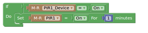

I'm not sure what the "Off Delay" is supposed to do. Maybe it's the length of time Domoticz waits before considering the Motion Sensor as "Off" - but that's not the case as I've tried setting it to 30 seconds, and although the light has gone off on the PIR, Domoticz still says it's "On" 12 hours later :-) It might be an internal timer that's used to send the Off command to devices that are actioned by it.
I use the following Blockly snippets to turn a real PIR (PIR1_Device) into a "virtual" PIR (PIR1) that's on for 1 minute. The PIR1_Device has "Off Delay" set to 0, and PIR1 Device is on a Dummy transceiver.
Blockly PIR Auto Off.png (12.39 KiB) Viewed 12082 times

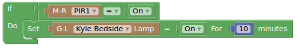

And the following Blockly is a light that relies on the PIR
Blockly PIR Action.png (13.26 KiB) Viewed 12082 times
It all seems to work :-)

Great nice approach to overcome the limitation of the Siemen's pirs and how Blockly works.
I think you are correct the "Off Delay" is the time Domoticz would wait after it recieved an "off signal", to give you time to leave the room before being plunged into darkness. The problem is that the Siemen's pirs don't send an off signal, they only send an on signal, then don't send anything until they next send an on signal, so the log in Domoticz shows each on signal recieved, but never shows an off signal.
I like the way you have used a virtual PIR to simulate what a more intelligent PIR would do, i.e. send an off signal if not activated for a set length of time.
The problem I was having combining the Siemen's PIRs with LightwaveRF lights using Blockly was that the LightwaveRF lights can be turned off mechanically by the switch, so Domoticz still thinks the light is on and Blockly won't send another on signal until the 1 minute is up even though the light is now physically off.
The other issue was for a shower room setting the time to 5 minutes, with Blockly the 5 minutes was from when you first entered the room, not from when movement was last detected, so the light always goes out before Blockly turns it back on. With LUA I have managed to set it up so the light stays on for 5 minutes after last movement detected.

I don't think it is appropriate for Domoticz to make a special case for these, the ByronSX PIRs only send an "on" signal, so really act as doorbells rather than classic pirs which send both "off" and "on" signals.
So use of Blockly, LUA or a Bash script connecting the ByronSX PIRs to lights / other devices seem the correct way to go.
