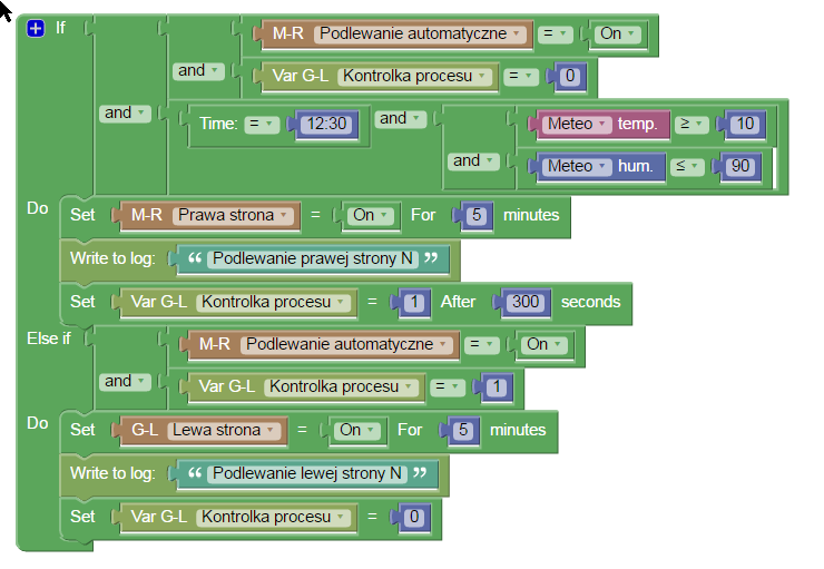

1) I have two sections of watering. First section is started after filling some conditions at sunrise:
conditions are set for tests, also time of watering =5min doesn't make a sense, it is for tests only, but doesn't matter. I'd like to add enabling of second section AFTER first will finish (they can't be opened in parallel at the same time). How to do that?
2) with this puzzle I can set time = sunrise/sunset or time = fixed hour. How to set a time = sunrise+30min?
3) and additional question, maybe it is possible to do not by "events", but other way: for safety purpose I'd like to add kind of supervision about watering, something able to control, how long valve is open (or how long water is flow - I'm planning to add flow sensor). If it takes too long -> alarm "overflow" will be generated, valves will be off, etc. How to do it?

You could create a User Variable - Type Integer, and do something like this?
Python:- Broadlink RM2, Sonos
JarekP
Posts: 15
Joined: Monday 16 May 2016 10:16
Re: Events: How to do something AFTER something
Post by JarekP »
ok, it looks real, thanks for help!

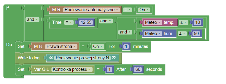

Something is wrong. Or it is not as easy as we think :)
First I built something similar to your suggestion:
First section is enabling on fixed time (for tests, after I will put "sunrise" here), with some other conditions. Second section is enabling with less conditions.
Results: first section ("prawa strona") was enabled on time, after 5 min variable "kontrolka procesu" was set to 1 and... nothing else. Second section not started, also in log there was nothing from this part of procedure, variable was still =1, also longer time than 5 min after finishing.
So I tried to do it with different method: by dividing it to two sepparate events. First, only for section "Prawa":
And it working fine and set variable to 1 at the end. So I though that only as I need is to detect this state by separate event:
But it doesn't work. After finishing of first section variable is set to 1 but this second event doesn't react for it, also in log I have only info from first event and nothing from this second one. Of course this event is active, switch "podlewanie automatyczne" is set to on all the time.

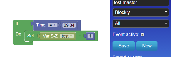

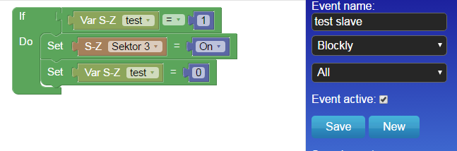

I tried to test only reaction for variables, made a simplest test. Two events:
Master:
and slave:
and it doesn't work also. On time event "master" is changing variable to 1, but "slave" doesn't react for it. However, when I manually set variable to 1, "slave" is working.Could you (or somebody) test it?

Problem solved. I used dummy switch instead of variable and now it is working. For me it is ok, but something has to be wrong with using variables, it should work also.
