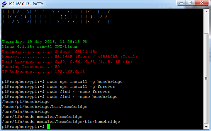

I've been trying for quite some time to get this working but I get stumped at the same point everytime.
I follow all the instruction but when I get here: "forever start /usr/local/lib/node_modules/homebridge/bin/homebridge"
This is the result: What am I doing wrong?

Looks like forever isn't installed or isn't in your path

There's only ONE guide for eDomoticz - first page of this thread. The issue tends to be people following guidance for an ancient version of homebridge & the previous Domoticz plugin (nothing to do with me!) before realising their error, and THEN trying to install eDomoticz & the latest homebridge... or they’re working on a system that has been in-use and has had a shafted node installation for ages without actually realising it.
Run each command separately...
Post the output
Post the output
Now find where forever is installed...
Post the output
And now find where homebridge is installed...
Post the output
sudo npm install -g homebridgeCode: Select all
sudo npm install -g foreverNow find where forever is installed...
sudo find / -name foreverAnd now find where homebridge is installed...
sudo find / -name homebridge

OK, i followed these instructions and this is what I got:Marci wrote:There's only ONE guide for eDomoticz - first page of this thread. The issue tends to be people following guidance for an ancient version of homebridge & the previous Domoticz plugin (nothing to do with me!) before realising their error, and THEN trying to install eDomoticz & the latest homebridge... or they’re working on a system that has been in-use and has had a shafted node installation for ages without actually realising it.
Post the outputCode: Select all

markk wrote:Marci wrote:There's only ONE guide for eDomoticz - first page of this thread. The issue tends to be people following guidance for an ancient version of homebridge & the previous Domoticz plugin (nothing to do with me!) before realising their error, and THEN trying to install eDomoticz & the latest homebridge... or they’re working on a system that has been in-use and has had a shafted node installation for ages without actually realising it.
That was exactly what happened to me. With a fresh, latest install of the Domoticz Raspi image, logged in as pi. Just no output, exactly like in the image above.
@Marci:
What I meant when I said that there are multiple guides...I meant going down the rabbit hole to get npm working,
Most of my searches ended pointing to outdated homebridge how-tos or previous Domoticz plugins, exactly as you said...
I finally found a solution using nvm to try different versions of node.js/npm ... some resulting in outputting: "illegal instruction" and some in nothing at all. After I got node.js 4.2.6 installed npm started working too and all went well.
Thanks again Marci for all you have done, your plugin is simply awesome. I did not want to sound like I haven't bothered reading through the thread or ungrateful in any way.

Ok - we can see from the output there that homebridge appears to be installed, but forever has failed to install. So, let's put npm in verbose mode, as it (now) defaults to quiet mode...markk wrote:
sudo npm -dd install -g foreverExtended Domoticz homebridge-plugin for latest Homebridge - adds temp/humidity/pressure sensors, power consumption sensors, DarkSkies virtual weather station support, YouLess Meter support, general % usage support & switch/lamp status checking!

I tried that and nothing happened
pi@raspberrypi:~$ sudo npm -dd install -g forever
pi@raspberrypi:~$Running Domoticz on Pi3 with RFXtrx433e. LWRF power sockets and dimmer switches. Integrated my existing wirefree alarm PIRs and door contacts with domoticz. Geofencing with Pilot. Harmony Hub. Tado for Heating. Now playing with mysensors.

Hmmm.... I suspect forever is failing to build in it's repo. Will investigate further. In meantime, use instructions for loading on boot here: https://github.com/nfarina/homebridge/w ... spberry-Pi (but note path differences - refer to your last screencap for paths to homeBridge, IE: yours is in /usr/bin not /usr/local/bin etc)
You can still run everything fine, just not via forever... so just skip the forever steps in the first post and continue on with the rest, then use details at link above to get it running on boot.
If forever is looking to be terminally screwed I'll update all the instructions to remove it, but as it stands, forever isn't required for anything else involved to work.
