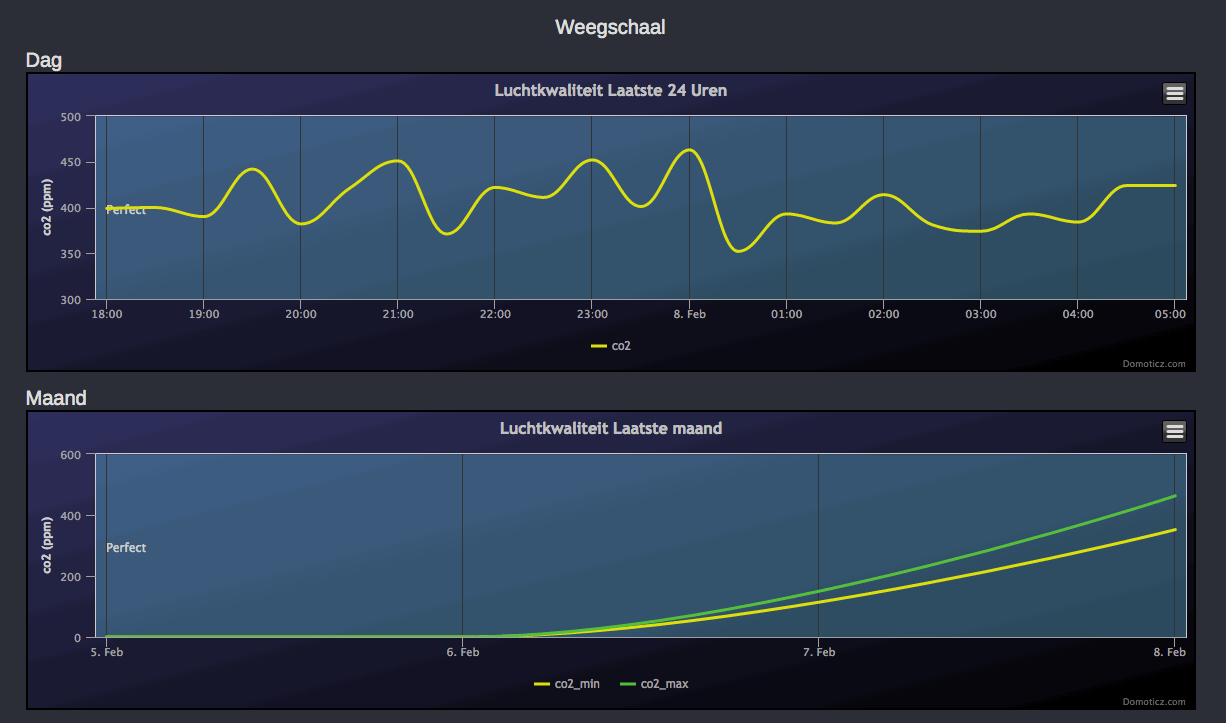

I got some data on the air quality graph! It doesn't fill the temperature graph though..
Which results does it download? It downloaded data from 7-02-16 18:00 till 8-02-16 05:00.
Is it wise to make a cron script every 12 hours, or not in this stage yet?
DISKSTATION> /volume2/homes/admin/DomoticzScripts/ws50-sync.py -u ********* -p ********** -c 103 -t 104 -d /volume2/@appstore/domoticz/var/domoticz.db -n
Withings WS-50 Syncer Version 0.2.0
[-] Database /volume2/@appstore/domoticz/var/domoticz.db
[-] Authenticating at account.withings.com
[-] Downloading data newer than 2016-02-07 09:45:00
[-] Updating database with 39 CO2 measurements [FALSE]
[-] Updating database with 39 TEMPERATURE measurements [FALSE]
DISKSTATION> /volume2/homes/admin/DomoticzScripts/ws50-sync.py -u -u ********* -p ********** -c 103 -t 104 -d /volume2/@appstore/domoticz/var/domoticz.db
[-] Updating database with 39 CO2 measurements [TRUE]
[-] Updating database with 39 TEMPERATURE measurements [TRUE]
[-] Committing and closing database
Thanks for working on this!!
Screen Shot 2016-02-08 at 17.48.09.gif (69.6 KiB) Viewed 6902 times
