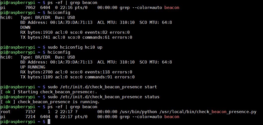

Nop. what command did you use ?
Look at this sequence :
Hurry up, It's the end of the Week-end ;-)

Here are the results:
pi@raspberrypi:~$ ps -ef | grep beacon
pi        1242   994  0 06:16 pts/0    00:00:00 grep beacon
pi@raspberrypi:~$ hciconfig
hci0:   Type: BR/EDR  Bus: UART
        BD Address: B8:27:EB:F9:9D:B1  ACL MTU: 1021:8  SCO MTU: 64:1
        UP RUNNING
        RX bytes:717 acl:0 sco:0 events:42 errors:0
        TX bytes:1532 acl:0 sco:0 commands:42 errors:0
pi@raspberrypi:~$ sudo hciconfig hci0 up
        UP RUNNING
pi@raspberrypi:~$ sudo /etc/init.d/check_beacon_presence  start
[....] Starting check_beacon_presence (via systemctl): check_beacon_presence.ser[ ok.
pi@raspberrypi:~$ sudo /etc/init.d/check_beacon_presence  status
● check_beacon_presence.service - LSB: This daemon manages the bluetooth low energy device detector : check_beacon_presence
   Loaded: loaded (/etc/init.d/check_beacon_presence)
   Active: active (exited) since lun 2016-05-09 06:14:10 CEST; 3min 23s ago
  Process: 366 ExecStart=/etc/init.d/check_beacon_presence start (code=exited, status=0/SUCCESS)
mag 09 06:14:10 raspberrypi check_beacon_presence[366]: Starting check_beacon...
mag 09 06:14:10 raspberrypi systemd[1]: Started LSB: This daemon manages the....
mag 09 06:17:26 raspberrypi systemd[1]: Started LSB: This daemon manages the....
Hint: Some lines were ellipsized, use -l to show in full.
pi        1445   994  0 06:17 pts/0    00:00:00 grep beacon
   Active: active (exited) since lun 2016-05-09 06:14:10 CEST; 4min 3s ago
mag 09 06:18:11 raspberrypi systemd[1]: Started LSB: This daemon manages the....
pi@raspberrypi:~$
There is something wrong on my side... :shock:

The log is stuck at
2016-05-09 22:24:00,747 - root - INFO - Connect to bluetooth device 0
But if I stop it
sudo /etc/init.d/check_beacon_presence stop
restart it
I get this
   Active: active (exited) since lun 2016-05-09 22:23:58 CEST; 50s ago
and this from the log
2016-05-09 22:25:53,640 - root - INFO - Connect to bluetooth device 0
