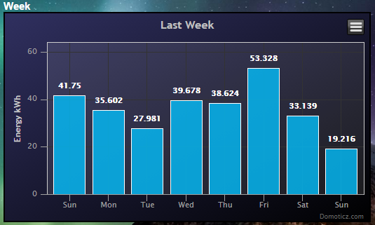

Is there someone here (no reaction on mysensors so far) who can explain this script a little, I’ve adapt it for my energy meter with 375 rotations per kW. Now I’ve changed #define PULSE_FACTOR to 375, and I think this give me not the correct values in Domoticz. I'm using an TCRT5000 sensor to track the black spot on the wheel of the energy meter, 375 pulses (rotations) = 1kW).
#define PULSE_FACTOR 375       // Number of blinks per KW(H) of your meter
Is this the only thing to change or do I have to do more and what to set in Domoticz, Setup, Meter/Counters, Energy Dividers (now it’s 1000). The counters are much to high now :?

The possibility is that with slower turning of the disc the count is 1 with black on and 1 with black off
Depending on the speed of the disc

NietGiftig wrote:The possibility is that with slower turning of the disc the count is 1 with black on and 1 with black off
That's not what i have seen, control led on TCRT5000 is always on and goes off when the black part is showing up. As far I can see. Image

proza wrote: That's not what i have seen
It is not so important what you see but what the software see and "thinks". :twisted:
The software must count the pulses not you.
Maybe the software thinks that on is a pulse, and off also a pulse.
Then i'll set the energy divider on 2000 to see off this give the correct results.

proza wrote: Then i'll set the energy divider on 2000 to see off this give the correct results.
That's a good start. :)
But remember that if the disc turns quickly the software maybe count one pulse because on/of is in the time limits of a pulse defined for the software.
In that case is the total also not correct.

NietGiftig wrote: That's a good start. :)
I'v used the code below for mine water- and energymeter to see what happens, and in both situations the serial monitor shows me a incremantal of 2 by one rotation.
So now i'v used for the energy meter the next PULSE_FACTOR
#define PULSE_FACTOR 750// Number of blinks per KW(H) of your meter
