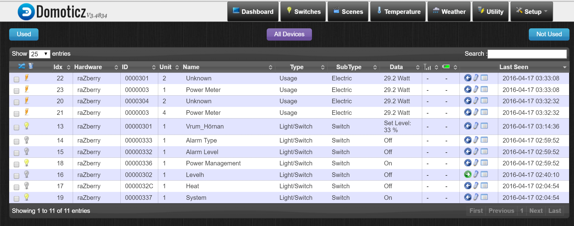

Today I installed my first Zwave, Fibaro Dimmer 2. I have no idea what all Devices that popped up is.
But i am missing Power Meter kWh. I have Watts which is right now, but I want total kWh. Will it pop up later or do I have to do something?
I have it installed with 2 wire, 1 switch on S1. Controlling 3 Halogen ~25 watts each.
Setting 50=10%, 52=3600, 53=10

All other users with a Fibaro Dimmer 2, do you know what all parameters means?Flopp wrote:Today I installed my first Zwave, Fibaro Dimmer 2. I have no idea what all Devices that popped up is.
Do you have kWh-parameter?

Yes I have subtype KWh meters for the Fibers 2. Usually they are on ID xxx01Flopp wrote:All other users with a Fibaro Dimmer 2, do you know what all parameters means?Flopp wrote:Today I installed my first Zwave, Fibaro Dimmer 2. I have no idea what all Devices that popped up is.
On the Domoticz dashboard this device then shows both actual power and usage.
I believe with default settings you only receive a usage report every 0,1 KWh so perhaps that did not yet happen or not while accepting new hardware. So you could try to change the update frequency to every 5 seconds and then include new hardware to see if that helps.
I too would like to know what all these devices (besides 2 switches, 2 levels, power and usage) do!

Thank you, I choose 60s then after ~30 minutes I got a new deviceBikey wrote:Yes I have subtype KWh meters for the Fibers 2. Usually they are on ID xxx01Flopp wrote:All other users with a Fibaro Dimmer 2, do you know what all parameters means?Flopp wrote:Today I installed my first Zwave, Fibaro Dimmer 2. I have no idea what all Devices that popped up is.

Just for information. When the first kWh has reached Domoticz it seems that Power Meter doesn't get updated anymore but Unknown still get updated. I think Power Meter and kWh get merged.
Could it be like this?

Funny, now I think of it, I had the same effect. But only with a new module I installed recently. The old modules keep updating the power device. But as you wrote, de KWh device on the webinterface shows both KWh usage and power. This looks like a bug in Domoticz to me.
