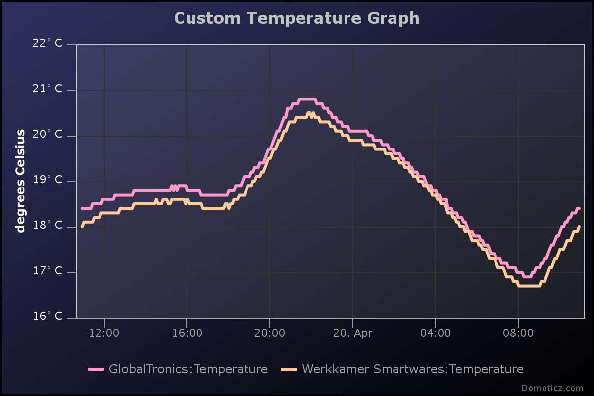

For illustration see the graph below, which shows temperature measurements taken by 2 separate sensors (different makes) that are 1 cm apart.
Measurements
Measurements
Of course the measurements should be identical, but there is a systematic offset of about 0.3 C - 0.5 C. That's not unreasonable for consumer-grade thermometers, but it's annoying and unnecessary because it's also something that can be easily remedied through calibration.
Of course I don't know which one is correct, but I want to at least make them consistent (so that when I put them in different rooms I won't be told that one room is always 0.5 C cooler than the other). Besides, I can always borrow a thermometer that's guaranteed accurate, and use that reading to calibrate both other sensors.
