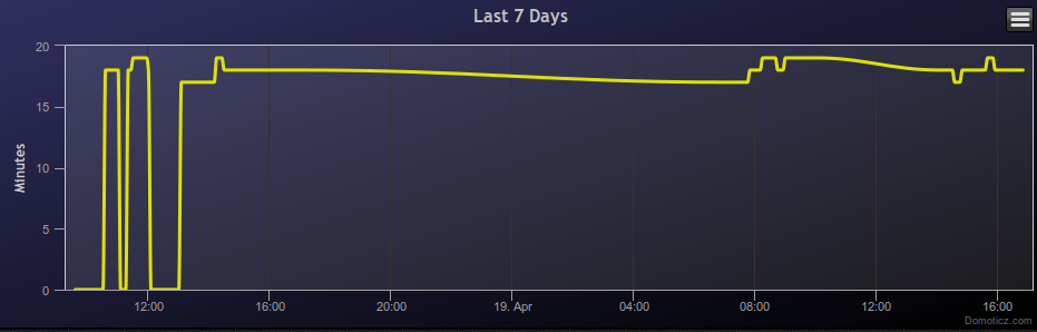

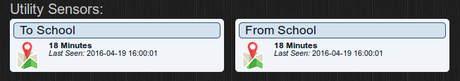

Re: Traffic with Google Maps in Domoticz
I've been trying this handy script... well done and thanks!
When I updated to the latest script my original dummy/custom sensors where "time to work" and "time to home" both with axis label minutes. With the new script, I set the 1st as idxtraffic and 2nd idxroute but both just show "18 mins" but I get in the log.
Any ideas?
2016-04-18 11:15:00.878 LUA: 18min to go to the office at 11:15 route Lynn Rd Any ideas?

woody4165
- Posts: 476
- Joined: Monday 14 March 2016 13:55
- Location: Rome, Italy
Are you getting traffic data from and to work at the same time? Meaning that you changed some working hours in the script?
The script was intended to get data from home to work at a certain hours and from work to home at other ones.
Don't know if this is the case.

woody4165
- Posts: 476
The Google API call is made within a function that is called in both case, home->work and work->home, and in both cases it return to the same variable.
Try to change this
into this
In changed the variable "traffic" into "traffic_Home2Work" in the morning part, and "traffic" into "traffic_Work2Home" in the afternoon part.
Try this. If it's ok, I will made this change in the script and post it fully.

Hi again Woody,
Sorry for the delay, I had an emergency trip to London
hate the place
So, here's my log output, note there is now no route info as before.
But I have found that my sensors were not frozen but since the code change at 1300 yesterday there has been minimal movement.
My big worry is that my sensors look like this, with no reference to "route"
Am I doing something wrong?
Sean

woody4165
- Posts: 476
Hi Sean
I think we have to distinguish two things.
Are these sensors text or what?
I'm using beta Domoticz and using a Custom sensor to get minutes number (and get graph) and a Text sensor to have the same text I'm going to send via Telegram, with the route.
So, if you want to get both information you get two choices:
you are on stable version (and you don't have Custom Sensor) or you don't need/want graph, you need to create two text Sensor and put there the complete text using something like these that you can find in my script published before:
if you want Custom Sensors to have also graph you can create either only two sensors, one Custom and one Text and use it for Home2Work and Work2Home, since they are in different hours, or either create two couple of sensor like before and get information separated.
Hope I haven't confused you more...
In any case, if you post your script I can take a look into it...
message=tostring(traffic_Home2Work)..'min to go to office at '..("%02d:%02d"):format(time.hour, time.min)..' route '..tostring(summary)
- blackdog65
- Posts: 311
- Joined: Tuesday 17 June 2014 18:25
- Location: Norfolk, UK
Yay! I have it! I had 2 custom sensor. I changed it to one custom and one txt and it works perfectly.
Many thanks Woody, I hope I can help you one day
