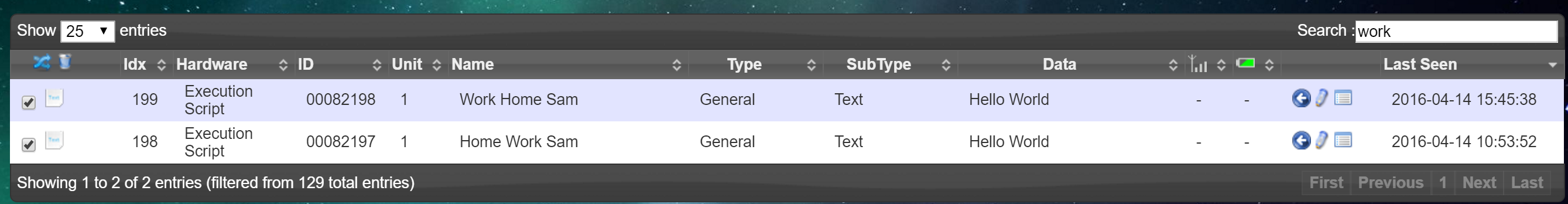

i use the stable domoticz version so i don't have the custom device. If i user a standard switch, i atttached the capture screen.
i found the script here :
http://domoticz.com/wiki/Lua_-_json.lua in the section : Lua script, is it this one i have to use ?
EDIT

the home-work switch is working it indicates a number. Sure it will be great with a graph, to bad i have to wait a new stable version.
i'll wait the afternoon to check the work-home is working

you can use a Virtual Dummy device and as type Text. This is what I used before the Custom Device
