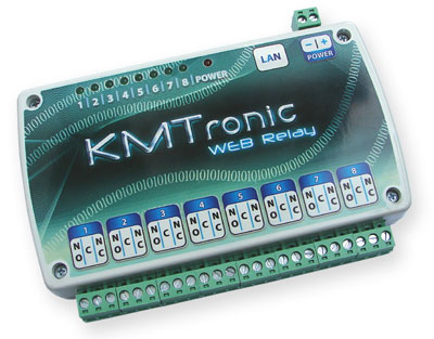

Since version #2434, Domoticz now supports the KMTronic USB and TCP(Web) relay boards.
They are not expensive, and the hardware devices look very professional
Supported:
USB:
1,2,4 and 8 channels
* needs external 12 Volt power supply with more then 1 channel
TCP(Web)
2 and 8 channels
More information is available at:
http://kmtronic.com

- KMTronic 8 Channel board
- kmtronic-web-8relay-box.jpg (34.43 KiB) Viewed 16794 times
