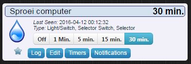

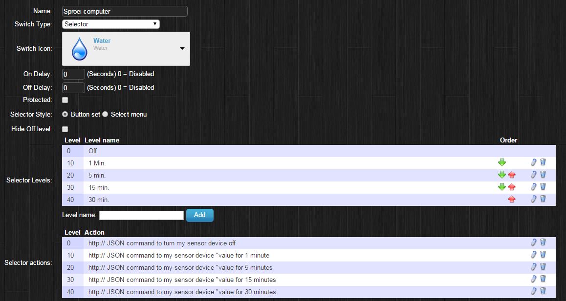

So i was reading a lot about Dummys and JSON. So far i have not find a function that sets a time, but i did found a selector switch that may just do what i need.
sproei compuer.JPG (21.91 KiB) Viewed 1696 times
Internally i could use JSON commands to sent a value to the mysensors device:
Will this work, and is it a efficient way to do this?
