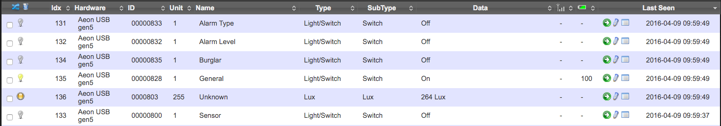

I purchased some Fibaro FGMS-001 multisensors, expecting them to work as flawlessly as my other hardware but it appears that the v3.2 Zwave+ model I got is not yet fully supported it seems.
Screen Shot 2016-04-09 at 10.02.41.png (22.62 KiB) Viewed 1100 times
I added the ID of the device to manufacturer_specific.xml, using the existing configuration for the FGMS and now it is detected and I can set parameters (yay!). However, the temperature sensor is not showing up in my devices list.
Screen Shot 2016-04-09 at 10.02.57.png (94.43 KiB) Viewed 1100 times
Behaviours:
Alarm type just receives "Off" signals whenever the device is moved, this seems to be the tamper detection.
Alarm level just receives "Off" signals, in sync with alarm type.
Burglar seems to be the motion detection, stops working when tamper is activated, starts working after tamper cooldown.
Unknown/Lux works as expected, reports lux value
General switched "Off" once, "On" once but does not respond to movement. Seems to indicate that the entire multisensor is operational? Has to do with the setting that turns of PIR at night?
Sensor switched "Off" once, does nothing else it seems.
Egregius
Posts: 2592
Domoticz version: v2024.7
Location: Beitem, BE
Re: FGMS-001 Zwave+ EU version 3.2 temperatur missing
Post by Egregius »
Temperature is only sent when the treshold is passed (parameter 60).
The motion sensor should end with id xxxx00 (in your case idx 133) (at least with the normal Zwave model).

It indeed showed up after tonight, it just took a little bit of time (and temperature change)!
