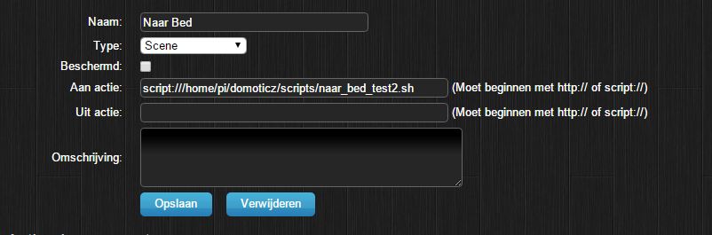

i have copy de scripts for test
#!/bin/bash
# prepare show for dimming white
./milight 1 b 1               # dimm to minimum
./milight 1 ON               # switch ON
./milight 1 w               # switch to white

i call it "naar_bed_test2.sh"
when i do ssh. connect from putty "pi@domoticzpi ~/domoticz/scripts $ bash naar_bed_test2.sh" it worked
but when i do
it dont work hou can i make it work ???

maybe change
to
where it says
script:///

no also i do script:// or script:/// not working

Put your milight executable in a place your script can find ;)
I think I put mine in /usr/local/bin or /usr/bin (don't remember)
Your script calls './milight' (needs to be in the current dir) but I don't think that's the right dir if you try to run the script from where you try it.

Then, your next problem will be where the milight executable expects the milight.conf ...
I don't like linking outside of the community, but this is what you need: https://www.safiweb.nl/?p=954
