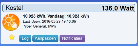

I made a lua script that logs the output from my solar panels. The actual output I use as a kind lux meter to switch on lights.
It makes use off a Python script piko.py. You can find it here. http://sourceforge.net/projects/piko/files/
I have one problem to solve. Some string manupilation.
And a question how can I get the total energy in Domoticz. Currently only the Current watts and the energy generated today is shown.
By the way if I look in the log at the chart for today it shows the same data as yesterday. Tomorrow it shows the correct data.
Here is it.

niki_lauda wrote: Tuesday 29 March 2016 19:10 1.jpg
Ja
Yes
Hi niki
How did you do?? I copyed your lua but get the same problem as you.
Thank you for help :D
