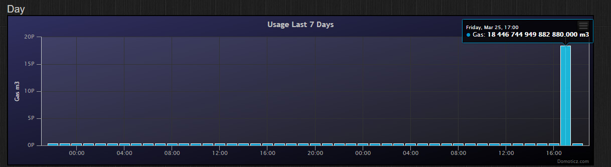

the value in the EEPROM whenever the sensor loses power and to retrieve data from EEPROM when booting up again. Then this value is sent to the controller. That actually works well, problem is: sometimes the value received by the controller is HUGE. Like in the picture:
Now, I think I may have found the problem but I don't know how to solve it: It seems to have to do with the fact that in my case I had to report a value for usage to the controller that was actually smaller than the one before (my sensor was registering too many pulses so the usage value was too high).
Now, Domoticz seems to interpret that negative amount as a huge positive number. I'd guess a problem with signed/unsigned numbers?

Yeah, well. Only, in this case the REAL value IS smaller than before. That's the problem. And this fact is misinterpreted by the controller by introducing an incedibly large number. Which can't be deleted anymore.

Imagine the following. I'm having a sensor which for reasons I have no influence on produces a value, i.e. a count, that has to be corrected from time to time. Manually. These corrections would imply that the count actually decreases instead of increasing.
Is it possible to do such a correction without producing a number with 20 digits in the process as it happens right now?
As I said: I don't know anything about what exactly happens when sending a value to Domoticz but I suppose this problem has got to do with the way those values are represented internally. If I send a negative value (previous value was larger than current value) to a program that only knows positive numbers then the negative number would be interpreted as a huge POSITIVE number. That's what I'm guessing here.

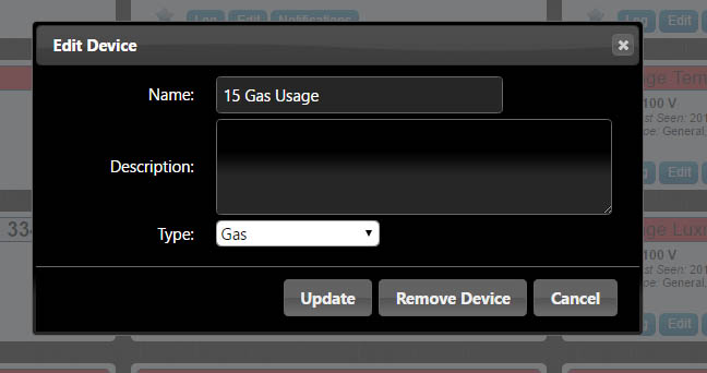

Okay, I see. Right now I'm using an "RFXMeter" for water and gas (which I think should be alright).
When presenting these sensors to Domoticz they are presented as a "watermeter" ...
gw.present(CHILD_ID, S_WATER);

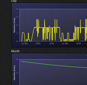

... and in Domoticz one has to change that to the appropriate type (energy, gas, water and so on). When doing that with gas it says "Waterflow" in the log chart. Where and how can I change that?

You can delete all you want, just shift-click with your mouse on the month/year graph, or delete them from the database.
Please note, that you are not using the sensors in a normal way, and i do not give any support for this, counters are incremental, and should never be set to a smaller amount
No. That's exactly what does not work. I can shift-click the whole day long. The value won't be erased, reason somehow being (again. Just supposing) that the value is insanely huge (did You look at the number? 20 digits?). Sort of a bug, if You will :)

What about my other question: the inscription on the graphic of my gas sensor says "waterflow". How can I change that one?

Please show me the devices tab with this sensor, as it seems this is not a gas sensor, a gas sensor's day values also do not display like this (yellow)

these are the devices:
And this is the relevant part of my Mysensors code:
MyMessage flowMsg(CHILD_ID, V_FLOW);        // message for usage
MyMessage volumeMsg(CHILD_ID, V_VOLUME);    // message for volume
MyMessage pcMsg(CHILD_ID, V_VAR1);          // message for sending pulse count
  gw.present(CHILD_ID, S_WATER);                                            // Register this device as water meter sensor (change to "gas" in Domoticz)
  gw.wait(3);
  gw.send(flowMsg.set(0));                                                  // Send dummy flow value to gw
  gw.wait(3);
  gw.send(pcMsg.set(pulseCount));                                           // send pulseCount to gw
  gw.wait(3);
  gw.send(volumeMsg.set((float)pulseCount / (float)PULSE_FACTOR, 2));       // Send current volume value to gw
  gw.wait(3);

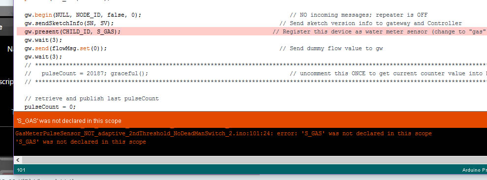

Yes, I know I am registering my gas meter as a water meter. Only, I couldn't find 'S_GAS', so I use 'S_WATER' and change that in Domoticz into "Type Gas", at least for the "usage". Seems to work.
How is it done correctly? :)
Chris

How do you mean there is no S_Gas ? There is...

But changing it to gas is also an option

gizmocuz wrote:How do you mean there is no S_Gas ? There is...
Using Arduino 1.6.5 and mySensors 1.5 ...
Christoph

gizmocuz wrote:But changing it to gas is also an option
As I wrote, all I can change when registering my meter as "S_WATER" is the type for the "usage". "Flow" has got no editable features...
Chris
